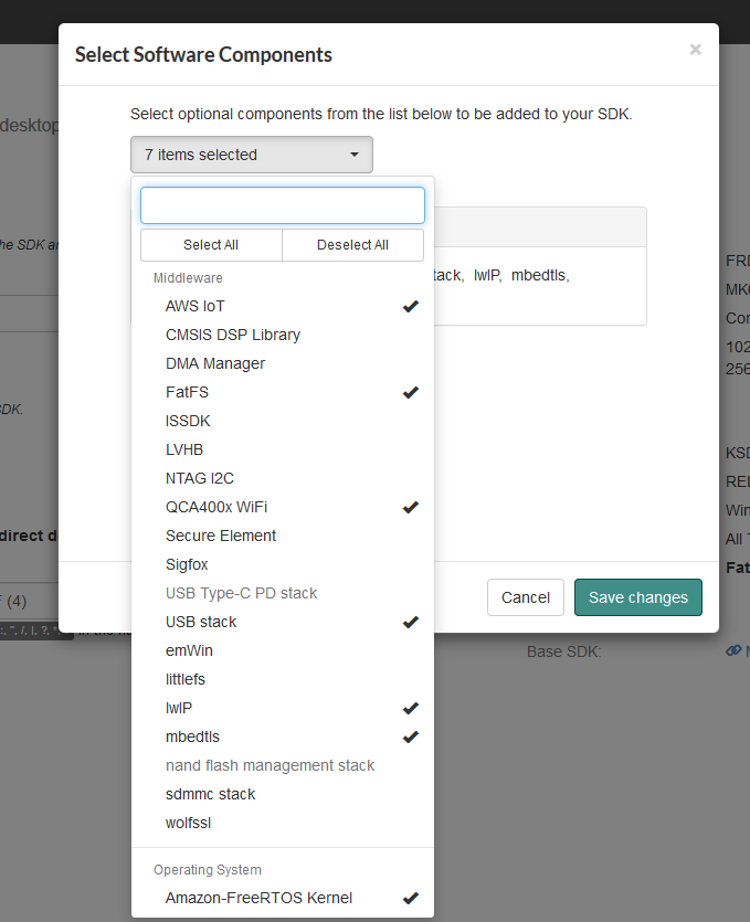

I am Interfacing temperature sensor with FRDM-K64F but need to connect the sensor with internet cloud to store the readings of sensor in CSV format, some suggested to use NXP SDK tools mcuxpresso I am using I2C interface and trying to write a code using this documentation but I am not able to understand how can I design and connect the application through internet cloud which shows the reading in dashboard for by using the CSV format data of sensor stored in cloud's database

Hi William:
I would suggest you refer to the aws examples in the sdk installation folder. The demos demonstrates how the board work with AWS IOT.
Please download the sdk from Welcome | MCUXpresso SDK Builder
and select components freeRTOS, AWS IOT, QCA440x Wifi,  before downloading
