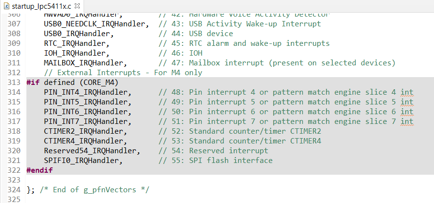

LPC54113 is a M4 but CORE_M4 is not defined for projects created using either SDK 2.8.2 or 2.9.0 (not tested using other SDK version). Hence the code generated in "startup_lpc5411x.c" is for M0 but NOT M4.
Please fix it in the next release.

conradkwok
Do you know what I am talking about?
I can run my program on LPC54113 without problem.
Have you looked at the file "startup_lpc5411x.c" ?
Without "CORE_M4" defined, g_pfnVectors won't include the extra interrupt vectors that are in M4 but not in M0!!!

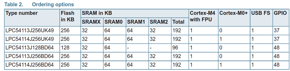

LPC54113 only have M4 core, NO M0 core.
Please look at the "startup_lpc5411x.c" file generated by the project wizards.
So "CORE_M4" should be defined, right?

Thank you, I see that the LPC54113 only has M4 core, NO M0 core.
You do not need to define the cortex-M4, because after Reset, only cortex-M4 starts, the Cortex-M0 hibernates even if there is M0 core.
Hope it can help you
