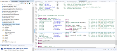

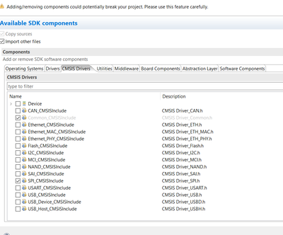

danielchen
I tried it on my newly created empty project based on MK12DN512XXX5,  selected the CMSIS drivers SPI_SMSISInclude , and I found the Driver_SPI.h and Drvier_Common.h are still there.  not commented out.   how can I reproduce your issue on my side?
I am using MCUXpresso IDE 11.2.1
