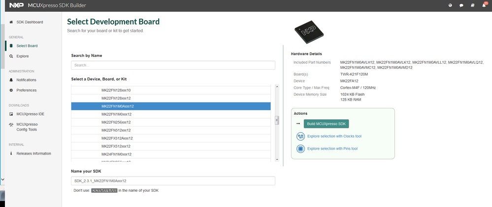

     I highly suggest you try the official SDK code for your MK22FN1M0AVLL12 at first.
     You can download the SDK code from this link:
https://mcuxpresso.nxp.com/en/select
    This code default chip is for TWR-KV21F120M board, but if you download the MK22FN1M0AVLL12 sdk code, the according header files , drivers and the system_chip files from this folder:
\SDK_2.3.1_MK22FN1M0Axxx12\devices\MK22FA12
  The project you can refer to this folder code:
SDK_2.3.1_MK22FN1M0Axxx12\boards\twrk21f120m\driver_examples\flexcan\interrupt_transfer
  But when you use the MCUXpresso IDE, please change the header file, the MCU part number, the system files, and the startup files, all these can be found from folder:
Please try it on your side.
