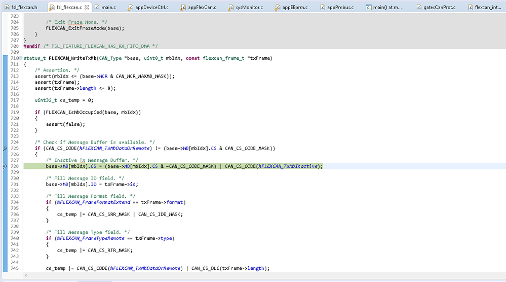

I am trying to port a K64/KDS3.2/SDK2.X project to MCUXpresso 10.3.X and SDK 2.5. I have made changes in the code of the KDS project to adapt the changes made in the new device drivers, and the new MCUXpresso project can be build and run.
I noticed that my CAN tasks can run but they cannot receive nor transmit any CAN messages. I used BDM to trace it down and found out that is because the transmitting MBOX is not available after sending the first frame out. Please refer to the screenshot below, it can only pass the condition in line 725 first time.
I was thinking it may be related to the changes made in fsl_flexcan.c/h, so I swapped fsl_flexcan.c/h files of SKD 2.x of KDS and SDK2.5 of MCUXpresso(with minor modification in both projects app), then find out, both flexcan device drivers of SDK2.x and SKD2.5 work for the KDS project but none of them work for MCUXpresso project.
Then, if it is not because of device drivers, what else? I am wondering if somebody else has seen the problem.
(I checked the flexcan examples, but FLEXCAN_TransferReceiveNonBlocking() was used there, not the API FLEXCAN_WriteTxMb() I was using)

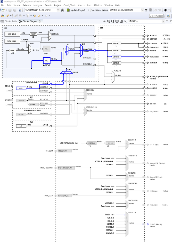

For a shortcut, if you see any clock issue in your project, you can configure it as one of the example project, such as hello_world, to get it right. Below is an example, I started a testing project and see there are some issues related to clock configuration, then I just use ConfigTools->Clock->Clocks Diagram to configure it as that in hello_world, then apparently all clocks in the project work fine.

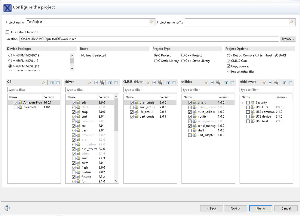

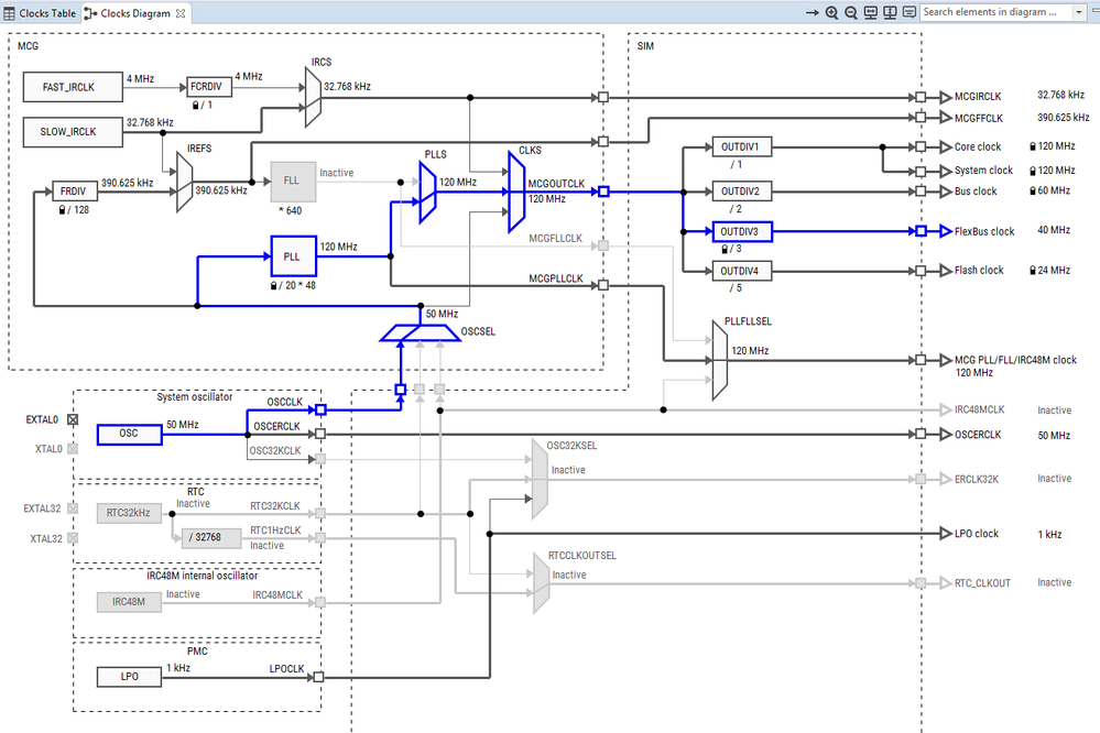

One thing to note, when create a project and using the FRDMK64 the board reference with SDK v2.5, the default clock configuration uses the PLL with dividers of 15 and 36 to generate 120MHz (assuming 50MHz OSCCLK) out of the PLL.  On the surface this seems fine as all of the derived clock frequencies appear correct.  However, we found in the CAN drivers, when the CAN bus timing is calculated based on the selected baud (250k in our case) and default PLL configuration, that the bus timing was wrong.  We were getting 3.8us vs 4us.
Stepping thru the initialization process with the default values revealed rounding errors resulted in an incorrect value be assigned to the preDivider parameter of the CAN timingConfig.  The calculation process was as follows...
OSCCLK = 50MHz
PRDIV = 15
VDIV = 36
fsl_clock.c   CLOCK_GetFreq()
MCGPLLCLK = (OSCCLK / PRDIV) = 50MHz / 15 =  3333333Hz
MCGPLLCLK = MCGPLLCLK * VDIV = 3333333Hz * 36 = 119999988Hz
BUS_CLK = MCGPLLCLK / SIM_CLKDIV1[OUTDIV2] = 119999988Hz / 2 = 59999994Hz
fsl_flexcan.c FLEXCAN_SetBaudRate()
priDiv = baudRate_Bps * quantum = 250000Hz * 10 = 2500000Hz
priDiv = (sourceClock_Hz / priDiv) - 1 = (59999994Hz / 2500000Hz) - 1 = 22.9999976, truncated to 22
This yields a CAN Serial Clock (Sclock) of...
Sclock = BUS_CLK / (priDiv + 1) = 59999994Hz / (22 + 1) = 2608695Hz
Which equates to a calculated baud rate of...
Baud = Sclock / quantum = 2608695Hz / 10 = 260869Hz --> 1/260869Hz = 3.834us.
If the value of PRDIV is changed to a value that is a factor of OSCCLK the result will be an integer, unlike the defaults shown.  So if PRDIV is changed to 20, for example, the first calculation of MCGPLLCLK will be...
MCGPLLCLK = (OSCCLK / PRDIV) = 50MHz / 20 =  2500000Hz
To obtain the desired PLL clock rate, a new value for VDIV is also required.
VDIV = 120MHz / MCGPLLCLK = 120MHz / 2.5MHz = 48
MCGPLLCLK = MCGPLLCLK * VDIV = 2.5MHz * 48 = 120MHz
These values then provide the correct BUS_CLK rate.
BUS_CLK = MCGPLLCLK / SIM_CLKDIV1[OUTDIV2] = 120MHz / 2 = 60MHz
Using these values in FLEXCAN_SetBaudRate() yields...
priDiv = baudRate_Bps * quantum = 250kHz * 10 = 2.5MHz
priDiv = (sourceClock_Hz / priDiv) - 1 = (60MHz / 2.5MHz) - 1 = 23
Sclock = BUS_CLK / (priDiv + 1) = 60MHz / (23 + 1) = 2.5MHz
Baud = Sclock / quantum = 2.5MHz / 10 = 2.5MHz --> 1/2.5MHz = 4us.
In summary, when choosing the divider values for PLL clock calculation, it is important that the PRDIV divisor chosen divides evenly into the PLL clock source providing a integer result.  The Clock Utility in IDE v10.3 will not catch this.  In addition, the PRDIV value chosen shall also produce a calculated value within the range of 2 - 4MHz as specified in the K64 reference manual.  The value for VDIV should then be chosen to obtain the desired PLL clock frequency.
It should also be noted, as described in the reference manual, for applications calling for a tight tolerance (up to 0.1%) in CAN bus timing, the Oscillator clock (OSCERCLK) should be used rather than the internal bus clock (derived from PLL in this case) by configuring CANx_CTRL1[CLKSRC] = 0.

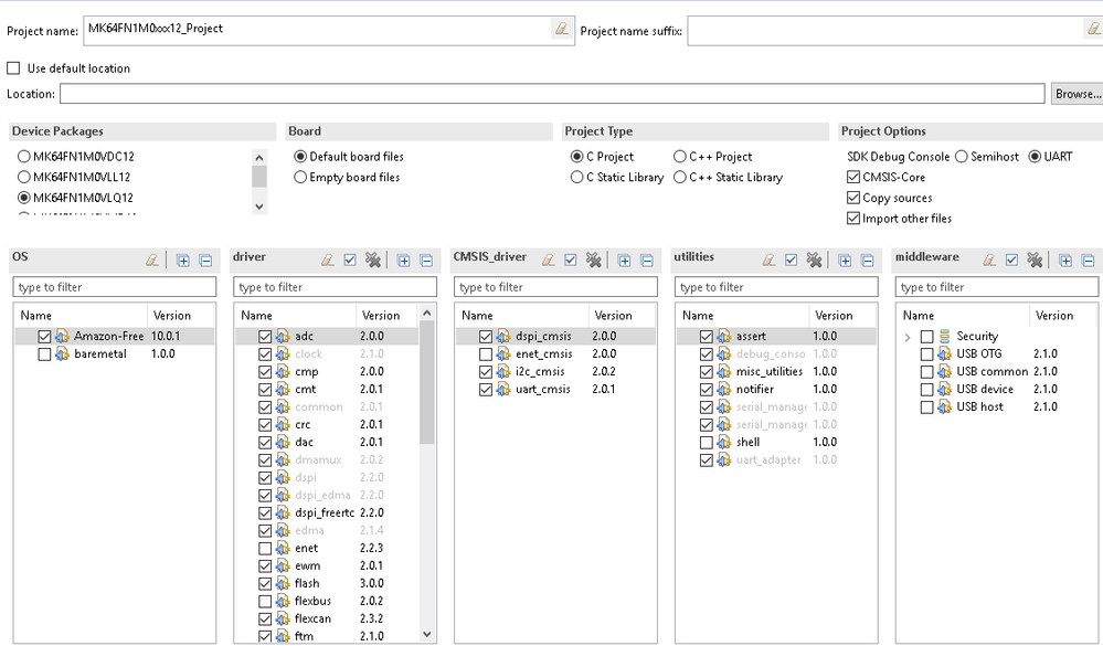

As you pointed out that if a project is created by picking a MCU but not a board, the default clock configuration need to be modified. When I created the project I have a default clock_config.c/h files created, but did not check for details.
I recreated the project, and selected FRDM64F board since the clock circuit of my project is the same as that in FRDM64F, and the clock_config.c/h works fine.

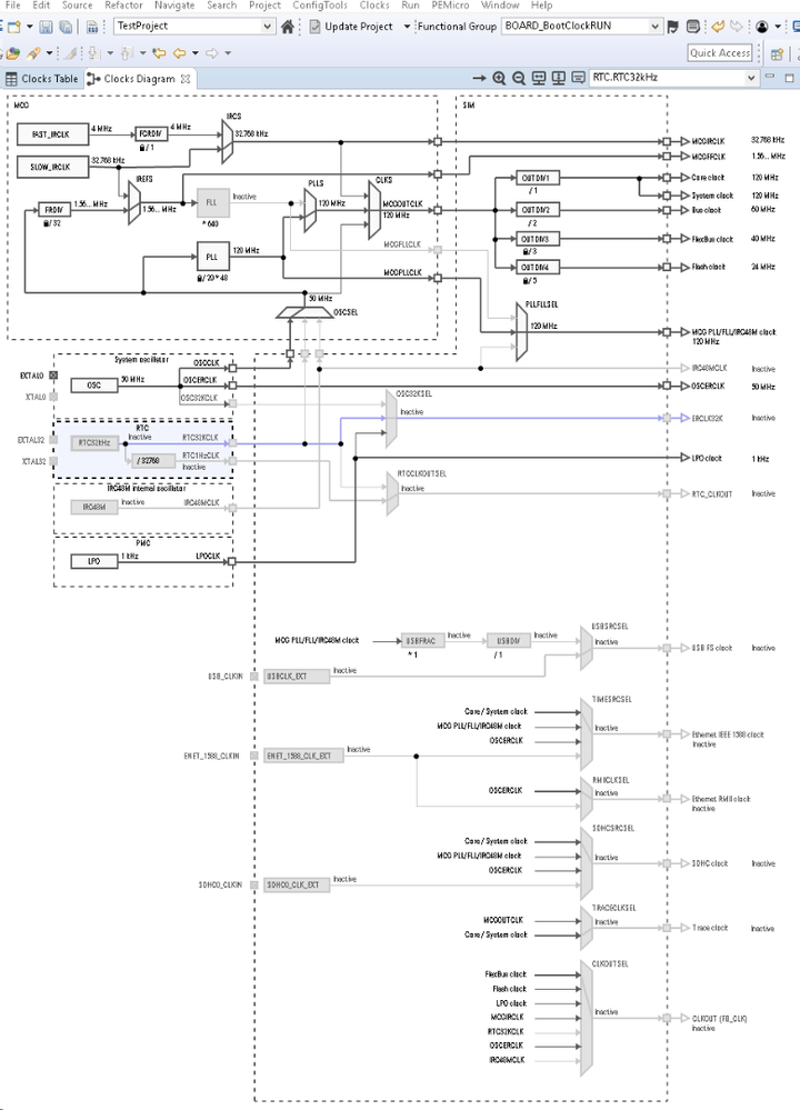

The issue is with default settings of the clock_config.c/h files added to the project when it is created thru the MCUXpresso New project wizard.  If the project is created without specifying a board file, generic clock_config.c/h files are generated.  The clocks are configured based on the parameters defined in the system_MK??? file found in the Device folder of the project.  You can use the Clock Config Tool within the IDE to configure the clock parameters.
If referencing a previous project, you can compare the old clock_config.c/h files to recreate new ones compatible with the latest drivers.
One thing that's annoying is that the files created when no board file is selected, includes a function called BOARD_InitBootClocks which gets included in the main function for clock initialization.

If you then use the Clock utility to configure the clocks and use the generated c and h files, BOARD_InitBootClocks no longer exists and instead is replaced with BOARD_BootClockRUN.  This requires the main function to be manually updated once the clock_config files are modified.
Example Clock Diagram configuration using Clock Config Tool
clock_config.h example output from Clock Config Tool
