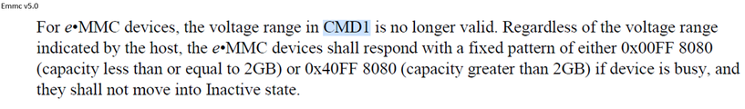

I'm using Kinetis K27 connected to a eMMC chip, 8 bits data, VCC=3.3v and VCCQ=1.8v.
After upgrading from SDK 2.7.0 to 2.8.0 the application no longer worked, it stopped in a forever loop in MMC_SendOperationCondition.
Unless I have misunderstood something, I had to add following code to fix the problem  :

Hi, Sorry for the late reply, i didn't get any notification about your query.
The device is a SanDisk iNAND 7250 supporting up to eMMC 5.1. Kinetis K27F supports eMMC 4.2/4.3 according to the ref manual.
Regards, Eldar
1,620 Views
danielchen
What is your emmc device version you are using?
