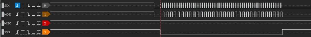

If you call the function SPI_MasterTransferBlocking with one of the flags kSPI_EndOfFrame, kSPI_EndOfTransfer or kSPI_ReceiveIgnore. the next time you call the SPI_MasterTransferBlocking without these flags, they will still be set.
The reason for this behavior is the line in the function SPI_MAsterTransferBlocking:
/* Read datawidth and ssel info from TXCTL. */
tx_ctrl = base->TXCTL & (SPI_TXCTL_LEN_MASK | SPI_TXCTL_RXIGNORE_MASK | SPI_TXCTL_EOF_MASK | SPI_TXCTL_EOT_MASK |
kSPI_SselDeAssertAll);
According to the comment, the intention is to keep the datawitdh and ssel, but all the above mentioned flags/bits are also read. To get the behavior as I would expect I need to change the line to:
tx_ctrl = base->TXCTL & (SPI_TXCTL_LEN_MASK | kSPI_SselDeAssertAll);
An example of when the function fails

The first call works as expected and the SSEL line is kept active. The second call works as expected where the SSEL line is set to inactive after the transmission. The third call fails where the SSEL line is set to inactive after the call as if the the flags EndOfTransfer and EndOfFrame were still set.
Please confirm if this is a bug or if I am using the driver wrong.

This can very easily be replicated with the SDK example (SDK_2.6.0 LPCXpresso845MAX). If you run the example lpcxpresso845max_spi_polling_master, you will get the result as shown in image
If you just add the two lines as shown below to the file spi_polling_master.c, you will get the following result
SSEL line is being set high for each byte during the second transfer
------ From spi_polling_master.c------>
/*Start Transfer*/
xfer.txData = txBuffer;
xfer.rxData = rxBuffer;
xfer.dataSize = sizeof(txBuffer);
xfer.configFlags = kSPI_EndOfTransfer | kSPI_EndOfFrame;
/* Transfer data in polling mode. */
SPI_MasterTransferBlocking(EXAMPLE_SPI_MASTER, &xfer);
------>  Added a second transmission to demonstrate the problem.
xfer.configFlags = 0; // Using ~(kSPI_EndOfTransfer | kSPI_EndOfFrame) will not work either
You can also observe that the EOT and EOF bits are still set in the SPI register. There is nothing that can be done with xfer.configFlags to reset EOT or EOF
I think it is better if you download the SDK instead of me sending you the files because my motivation for this post is to verify if this is a bug in the SDK, and if so, hopefully NXP will fix it for the next version of the SDK
