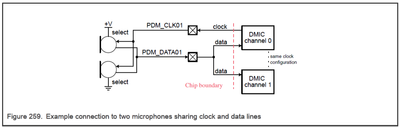

There is also ambiguity on the possibility of muxing two PDM streams on both edges through a single PDM_DATA input pin which according to RM's Figure 259 seems to be possible,
but with the issue stated above as well as the fact that the PDM_DATAn pins can seemingly only be connected to one DMIC channel, I'm not sure about this.

  • There is also ambiguity on the possibility of muxing two PDM streams on both edges through a single PDM_DATA input pin which according to RM's Figure 259 seems to be possible,

Concerning RM's Figure 259 : after some experimentation on the EVK and re-reading the Figure, it's clear that it's only possible to share the CLK pin but not the DATA pin.
The fact that the Figure mentions 2 pins (CLK and DATA) which are not on the chip boundary red dotted line did mislead me.
Maybe it was meant to mention 3 pins (1CLK and 2DATA) on chip boundary which would make more sense?

I've confirmed that the configuration is possible. The important aspect to consider is that each channel is going to be configured on a different edge for writing and the MCU will read the opposing edge for each channel. Each DMIC has a pin select to configure the edge that it will write on.
As far as the configuration seen on the figure, this is correct CH0 will provide the clock and CH1 will share same clock and frequency, then data line is also shared but as mentioned they will be on different edges.
