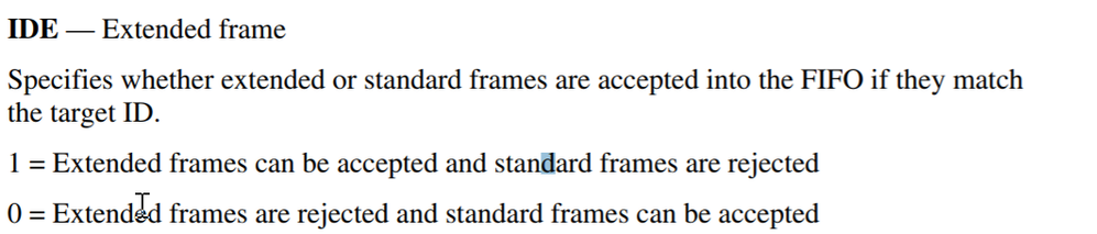

As you're declaring the FIFO matching ID table looks good but in the FLEXCAN_RX_FIFO_EXT_FILTER_TYPE_A API the last field mentions the IDE bit. I see that you're using an extended frame si the IDE should be 1:
Alexis Andalon
