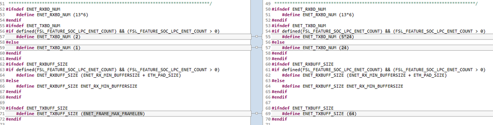

I have updated to SDK 2.8 and I think I have found the cause of this headache. I suspect SDK 2.7 should work allright, although I have not tested it. I had been trying to optimize the ENET DMA by setting a larger amount of buffers of a smaller size. This seems ok for the Rx buffers, but somehow not for the Tx buffers.
On the image below you can see a snippet of enet_ethernetif.h under lwip/port folder. The right side shows my previous code, whereas the left side illustrates my current code. Do you have any idea why having 24 Tx buffers of 64 bytes is not valid, whereas 1 Tx buffers of 1518 bytes seems allright?

embeddeddavid
Hi kerryzhou‌,
Just the other way around: the left-side code is currently working. Do you have any clue why?

kerryzhou
Hi embeddeddavid,
    So sorry for my later reply.
    I checked the SDK2.8.0, the ENET_TXBD_NUM is 3.
Do you use the SDK2.8.0 driver directly? Whether it works with the ENET_TXBD_NUM=3, and the ENET_TXBUFF_SIZE as 1518?
Or you still need ENET_TXBD_NUM to 24, I think maybe this number has the limit, but the ENET_TXBUFF_SIZE can large. Do you try any other  ENET_TXBD_NUM data below 24, whether it works or not?
