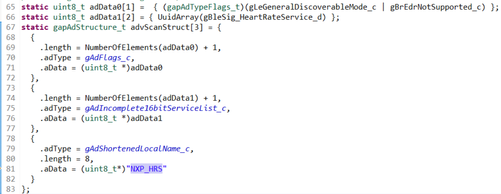

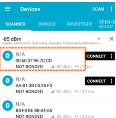

Hello
I am using the device #KW38 EVB
When I test with two example code; <heart rate sensor>,<blood pressure sensor>, I found some difference of SCAN result.
(I tested with SAMSUNG Galaxy Note 9 phone)

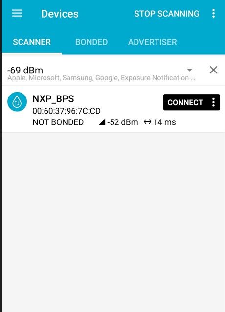

Using <blood pressure sensor> , the [Device Name] in host is always [NXP_BPS]. Exaclty I expected.
BUT, Using <heart rate sensor> , the [Device Name] in host is always [N/A]. I expected [NXP_HRS].
I have No idea what makes this diffence. Anybody can explain this and how to fix the fault scanning result?

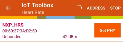

Did you modify the source code of any of those examples?
What is the android version of your android device? Can you test these applications with a newer android version?
You mention that you tested other projects, and the same issue occurs, could you please confirm if you observed this behavior using the IoT Toolbox App?

I Tested other example projects. Two of the projects <Heart rate sensor/BLE Shell> are shown the same symtom. The others are FINE.
1. Cycling Power Sensor[NXP_CPS]
2. Glucose Sensor[NXP_GLS]
3. Health thermometer[NXP_HTS]
4. Heart Rate Sensor [N/A] <====== Error
5. Proximity reporter[NXP_PXR]
6. Running speed cadence sensor[NXP_RSCS]
7. Wireless uart[NXP_WU]
8. Ble_Shell [N/A] <====== Error
