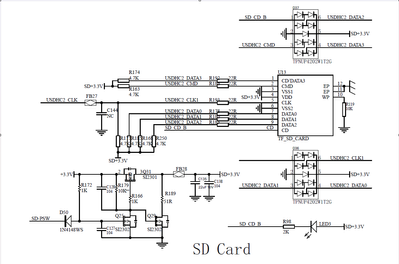

My SD card uses an SD pin to detect if the card is inserted or pulled out. Here is my schematic section.
When I inserted and removed the SD card several times, my led could not correctly recognize the SD card status, I checked the pin level and it seemed to have been clamped by the MCU at 3.3, because when I disconnected the MCU, it was able to correct the status of my SD card.
