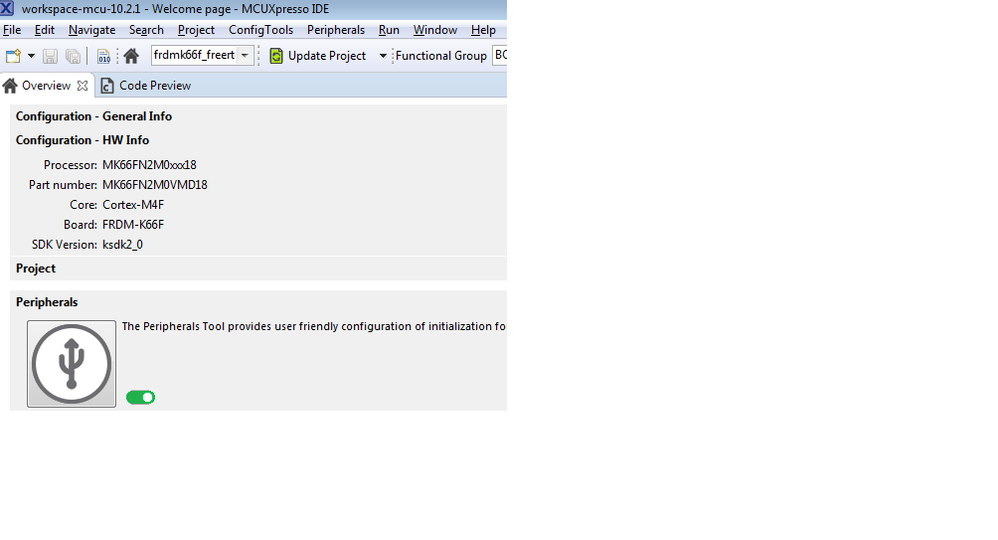

To open the tool, simply right click on the project in Project Explorer and select the appropriate Open command:

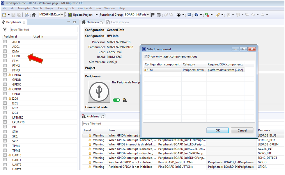

With the peripheral Tool, we can use it to configure initialization of selected peripherals and generate code for them. we are picking the FTM0 timer ,of course we could use any other timer too.

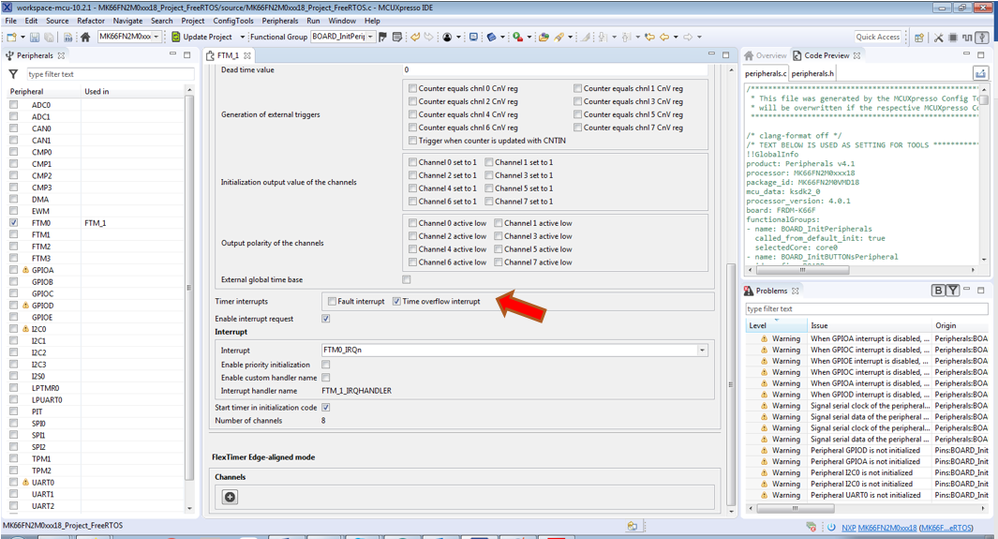

Click OK, then configure the timer to 10KHz.
We will use the timer interrupt to increase a counter, so don’t forget to turn on the interrupt
To update the generated code in the related tool chain project, click the Update Project button.
Click OK, new code will be generated. Please check peripheral.c & peripheral.h

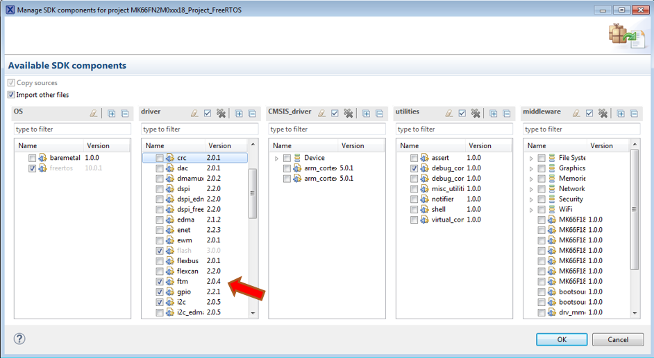

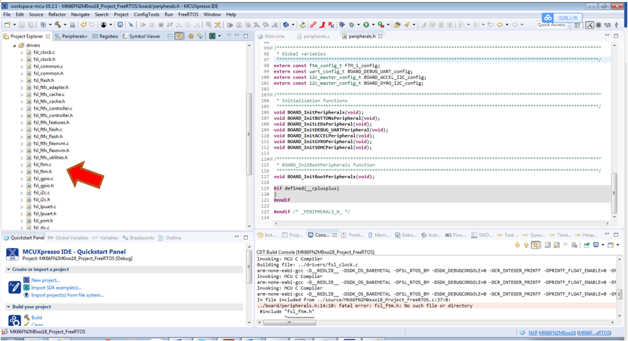

The project won’t compile yet, because the necessary drivers are not part of the project yet. To add them, use the ‘Manage SDK components’ button:
Then check the ftm driver and press OK and get the extra driver sources added to the project.
We can see that fsl_ftm.c & fsl_ftm.h added into this project.

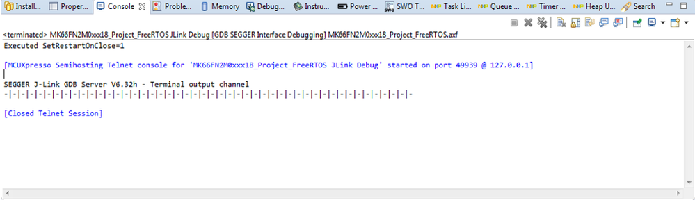

Run the demo
console output:

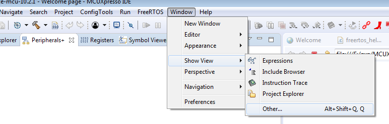

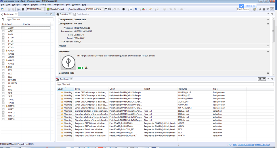

Hi Daniel,  when I click the 'open peripheral' , I can't see the peripherals view, as below, why?
Hi David:

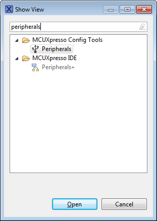

Maybe you closed the peripherals view, please open it as below.
click other...
input peripherals, then click open, you will see the peripherals view.
