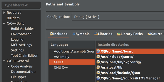

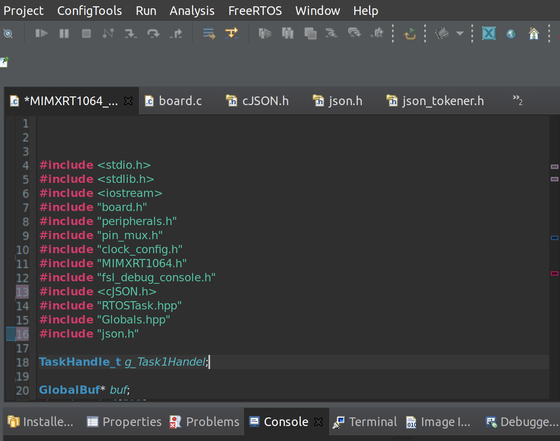

paths are included as below in both compiler MCU C and MCU C++, both libraries work fine in cmake as stand-alone projects but not in MCUxpresso even after adding the paths as shown in the screenshots.

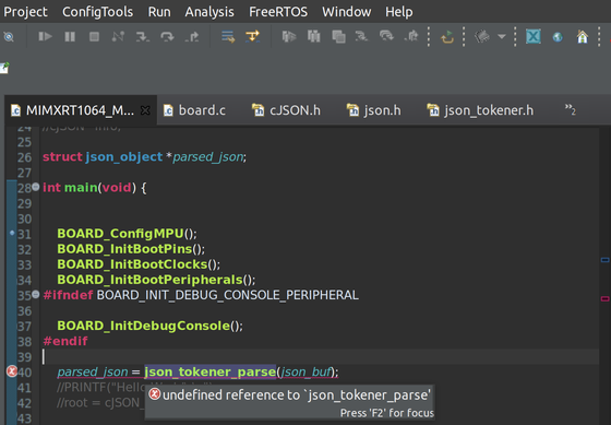

the undefined reference error is applicable and occurs to all functions in which called from either of the two cJSON.h or or json.h but never on cmake since it knows where to go! Really frustrating with latest NXP SDK's API where they removed the cJSON api which was even a replica to the repository and didn't include instructions to integrate this stubborn IDE!

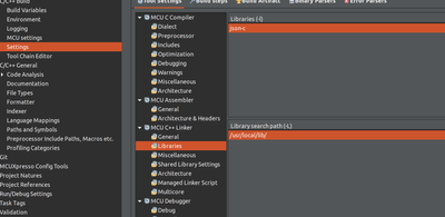

Undefined reference is a *linker* error. You have not added the json library to the linker.
9,499 Views
mazimcoder
paths are already added in the linker, yet the problem prolongs
9,491 Views
converse
Senior Contributor V
Have you added the cjson library to the linker? Snapshot the linker libraries page, and post it.
note. If the library is called libcJson.a you just add cJson to the linker (it will automatically add lib to the front and .a to the end)
9,485 Views
mazimcoder
still nothing!
9,480 Views
converse
Remove the first three letters “lib” from the name of the library. See my earlier comment
9,479 Views
mazimcoder
persisting to never work out!  (with/without lib or .a) even after cleaning and re-building the project

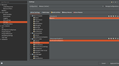

mazimcoder
it works at this path now but I got a brand new absurd error! Apparently, the .so file isn't recognized
9,475 Views
converse
Where did you get this library? .so file is a Linux shared object library, which is not compatible with embedded devices. You will need to find a version of this library built for ARM Cortex embedded applications.
9,474 Views
mazimcoder
unfortunately, most of C/c++ based library are GCC for x86/64 and not ARM, I got it from here;
https://github.com/json-c/
if you know one that works with ARM, please share it!
9,472 Views
converse
Well, you are not going to get a Linux x86 library linking with anything for Cortex. But the site you pointed at provides source code, so you can just download the source code and build it yourself - but it may need some porting. For example if it is designed for Linux, it may use Linux system services, that will not be available on your target device.
