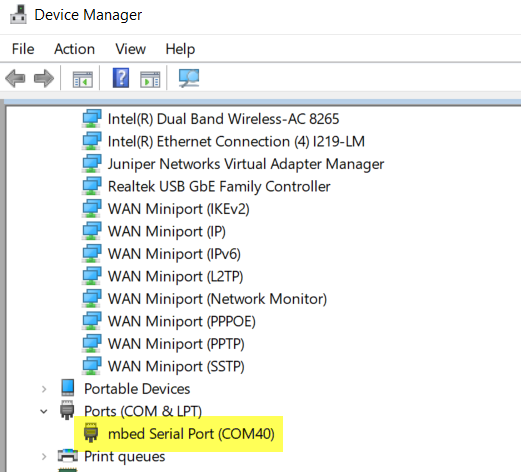

Regarding to your question, please first check whether the LinkServer debub probe been detect
from Device Manager of PC , like this:

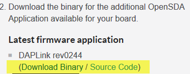

If there isn't, update the OpenSDA refer to OpenSDA Serial and Debug Adapter | NXP
use "DAPLink rev0244":
BTW, what about your PC system, if Win10 , please first update bootloder  refer to:
Freedom OpenSDA Firmware Issues Reported on Windows 10
