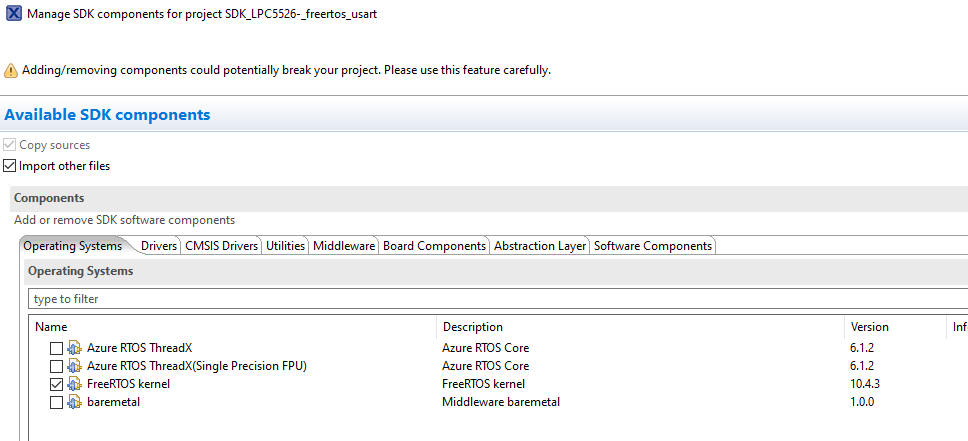

For example I imported the FreeRTOS USART example from the LPC5526 SDK for the LPC55S28 MCU (that's possible because the SDK includes examples for the LPCXpresso55S28 eval board).
From the Project Explorer, the context menu SDK Management > Manage SDK Components opens said wizard:
"FreeRTOS kernel" is selected. On other tabs (Drivers, ...), the included SDK components are selected, too.

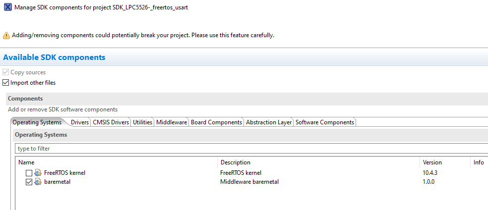

Now I switch MCU to LPC5526 that has a different memory setup but is otherwise compatible with LPC55S28 MCU (with regard to this example). Then the wizard looks like this:
The IDE has completely lost track of all SDK components that are included in this project. I cannot further add/remove SDK components. Peripherals tools complains about missing SDK components.
Of course, the source files are still in the project, the project compiles. Only the meta information about the included SDK components has gone missing. Switching the MCU back to the original one does not help.
Why is all SDK meta information lost when switching MCU?

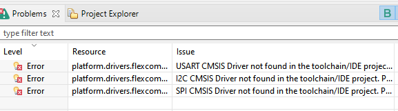

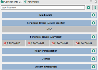

I observed that switching MCU also breaks Peripheral Tools. It shows errors and reports missing drivers:
Components view:
List of problems:

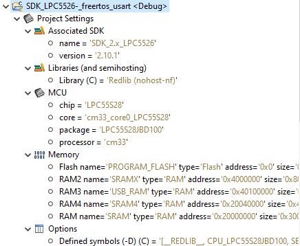

I tried your workaround and found it to be incomplete. I observed all changes to files for each step by putting the project under revision control.
As a starting point, I'm using the "FreeRTOS generic" example (based on the LPC55S28 MCU).
Immediately after changing the MCU from LPC55S28 to LPC5526, by opening "Manage SDK Components" I see that the component information has been lost.
Closing the project, editing .cproject as you described (copying over the previous <storageModule moduleId="com.nxp.mcuxpresso.core.datamodels"> section), and opening the project again, I see that the correct component information is available in "Manage SDK Components".
However, now the MCU information is incorrect (shows LPC55S28) and I can not properly set the packaging of my MCU (i.e., LPC5526JBD64).
