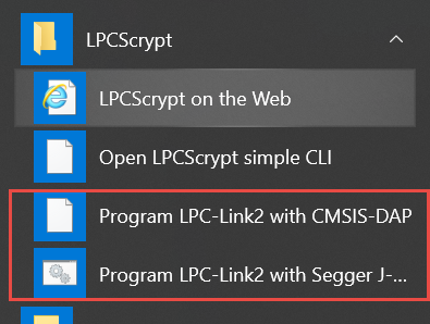

Try update LPC54S018-EVK on board debug firmware with latest LPCScrypt.

I ran the program_CMSIS.cmd and program_JLINK.cmd scripts and both succeeded, so it should be up-to-date, and I'm still seeing the same problem.

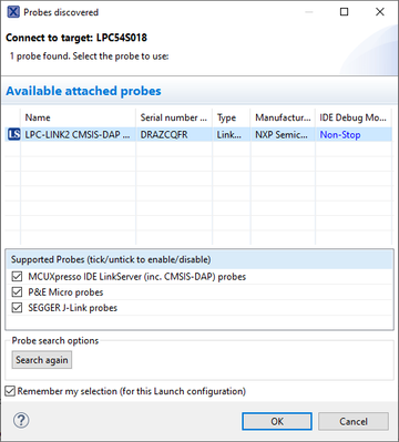

What I mean is you asked me to test CMSIS-DAP and J-Link. I only have CMSIS-DAP onboard, right? That's the only option I see anyway, either on the PCs that work or the one that doesn't.

I mean you can use LPCScrypt to update your on board firmware to either Jlink or CMSIS-DAP
I ever have customer's system can work well with one of the interface. that's why I suggest you trying.

I ran those as previously requested, and they appeared to succeed, but it didn't make a difference.
As for J-Link, I'm only seeing CMSIS-DAP:
Is there something I need to do to use J-Link? Is it on the LPC54S018 board or do I need external hardware?
Anyway, none of this should matter, because multiple boards work with multiple different PCs. I can't imagine how this could be anything other than a software/driver issue on the PC side.

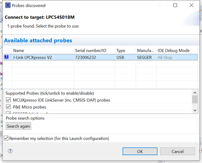

According to your screenshot, the debug firmware is CMSIS-DAP, not Jlink. Please follow attached video to update the firmware to Jlink interface. You need install JP5 to enable DFU mode before connecting board. Make sure the update successful
If firmware update successful, you will be able to see Jlink when connecting.

Okay, I think I got it now. I needed to remove the JP5/DFU jumper after programming the J-Link interface.
I didn't think to do this sooner because it wasn't necessary for CMSIS-DAP.

J-Link worked after removing JP5. I didn't know I needed to do that, because I didn't need to do it for CMSIS-DAP.
