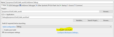

When I press "Debug" in quickstart panel, it always starts from the building before doing debugging. Additionally, when I reopen my workspace and press "debug", again it will start building. How can I use "debug" without building an already builded project, and how can I make sure that when I make a change in a certain file, only that file is built (not the whole project)?

First, you can disable the build before launching, see https://mcuoneclipse.com/2020/07/17/eclipse-gems-tips-tricks-faster-debugger-start/

It partially solved the problem I had when I debug the project, now it builds only the files I changed and debugs. However, when I close and reopen the ide and press debug, it will automatically starts from the building(i did not unpick the option of build(if required) since I would like to see build on those files which I changed) even if i totally builded and run debug from previos session.
I would like to see building inside debug when I make changes on certain files and building should be done on those files then running debug. Additionally, when I reopen the ide and run the debug, I do not want to have the build process(unless I make changes) before debug, since I have not changed anything.

The IDE uses incremental builds whenever required. For disabling incremental builds when initiating a debug session, you have the option to disable this in the launch configuration.

Yes, the setting below (if disabled in the workspace settings or disabled in the launch), prevents a 'build-before-debug'):
But the main point (which I can confirm is): whenever you start/restart the 11.7.0 IDE and load a workspace, it will perform a full build of the project, even if nothing has been changed.
