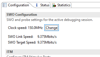

At 150MHz (full speed) core & traceclk all is well.
The IDE detects the correct speed:
and the SWO ITM Console then shows the correct output (I set a breakpoint after the calls to pins, clocks, and peripherals init, and then do the SWO configuration "detect", and then finally start the SWO ITM Console):

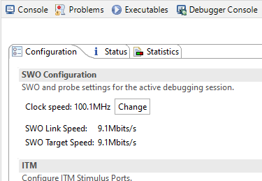

According to the ClockConfig tool the freq. is actually 100.1MHz

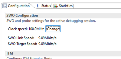

Either way if I use the autodetected speed (100.1MHz) or if I override it to 100MHz the SWO ITM Console output is garbled:
At 100MHz:
At 100.1MHz:
I've attached my generated "Clock" files - any pointers as to what I'm doing wrong?

As an update to this, redid the project, but reduced the clock to 96MHz (rather than the 100 / 100.1 that was giving strange results) and the ITM is working again without issue.
