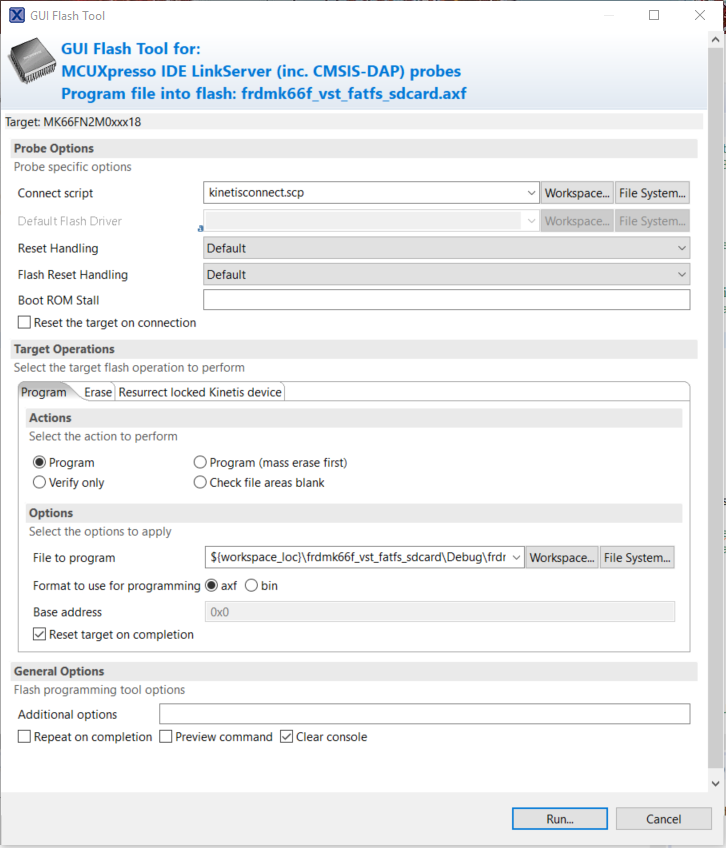

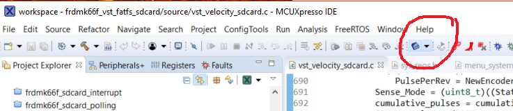

Thanks, but not using Jlink because every time you fire up the debugger or programmer, there is some damn licensing thing that says that you have to agree to only use in demo mode or a license of jlink is needed, etc. etc.  even though we are using as demo there is grey area of what is demo and what is production,  if we build 100 do we need to buy 100 jlink license,  etc..  so piss on them, we use the CMSIS-DAP free ware from ARM.   the reality is what I am looking for is a way to run a script, or have a click on an icon run a script to get me to this "GUI Flash Tool"  menu.  It looks to me If I can some how get to this menu/tool then all I need to do is provide a *.axf or *.bin file.   you don't need the entire project and source code.  In reality maybe I just have them install MCUExpresso and launch the programmer using the Icon on the tool bar,  like shown below, but I suspect the tool also needs additional files, like a symbol file and a kinetis config file, I will go through the manual and see what I can dig up.

The short answer is that we do not provide a standalone package for flash programming. I recommend going through the MCUXpresso IDE User Guide to identify what flashing procedures fit you best. More specifically, I'm referring to the GUI Flash Tool and LinkServer Flash Support chapters.
The GUI Flash Tool offers the possibility to generate the command line script for a given operation. Please note that the script will point to MCUXpresso IDE and SDK folders, so these will be required on the host where the command will be executed.
