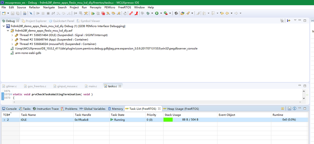

I'm using frdm-k28 and P&E opensda onboard debuger, in a freertos project, the problem is tasks listed in < debug > window, but not listed in <Task List (FreeRTOS)> window. anyone met and fixed this problem ?

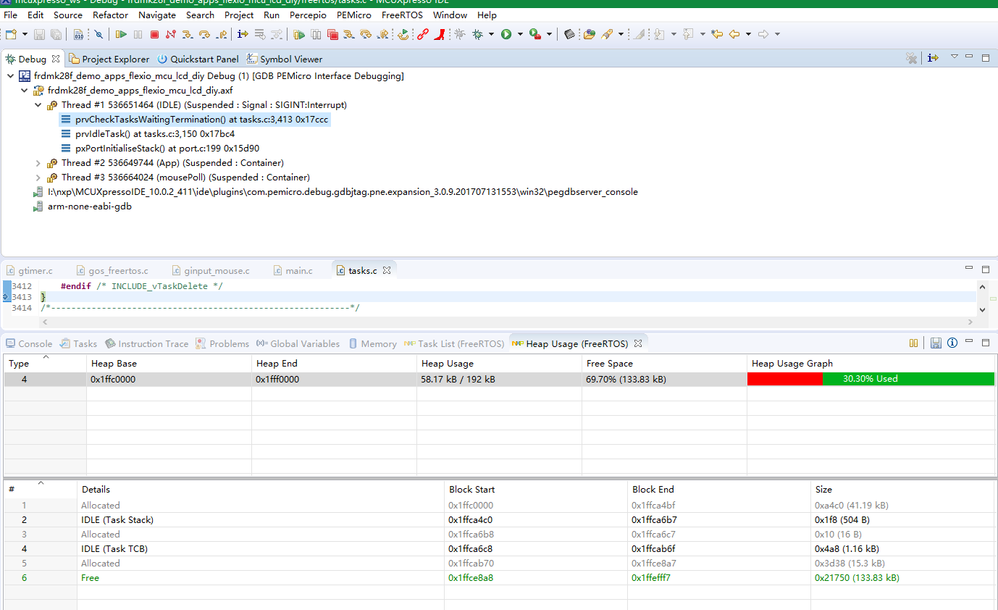

The < Heap Usage (FreeRTOS) > window works as blew pic.

Hi Erich,
In the debug console , there is the message "  rtos symbels initilized "
3,542 Views
BlackNight
Hi Kevin,
that message is from the P&E debug connection which properly shows the threads in your screenshot. So P&E is working fine. What somehow does not work is the NXP Thread List in that view.
There are some debug logs of that view present in your workspace.
Can you check (or better: post) the log files present inside your workspace folder? They are located in a folder named FreeRTOS_TAD_logs?

BlackNight
Hi Kevin,
the problem is created by your app task
    xTaskCreate(app, "App", 1024 * 20, NULL, uart_task_PRIORITY, NULL);
Above you are creating that task with 80 kByte (!!!) stack. This causes problem in the task view (of course it should not create that issue, so I have reported it to the developer).
If you use 4K (1024) instead of 80KByte, the problem goes away.
