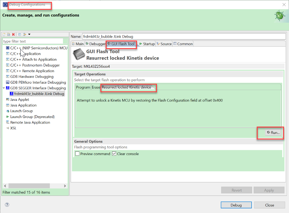

Hui_Ma
From your provided info, I don't find KL17 SWD debugger interface with any hardware issue.
For the new board, there could exist KL17 locked at first time.
Please check below picture to use [Debug Configurations] provided [GUI Flash Tool] to unlock KL17 at first:
Wish it helps.
Mike
17,662 Views

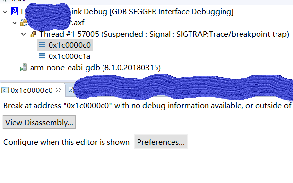

topkinschen
Hi Mike
    thanks for helping.
    your reply helps me ,it sames new chip lock problem.
    but new problem rise up after I unlock the chip and debug
Break at address "0x1c0000c0" with no debug information available, or outside of program code.
 thanks again.
17,661 Views
Hui_Ma
It looks debugger works, while during debug, the core load the incorrect code from incorrect address.
Please power off and re- power on the board and debugger tool.
Then do the debug again and check if there with the same issue.
best regards,
Mike

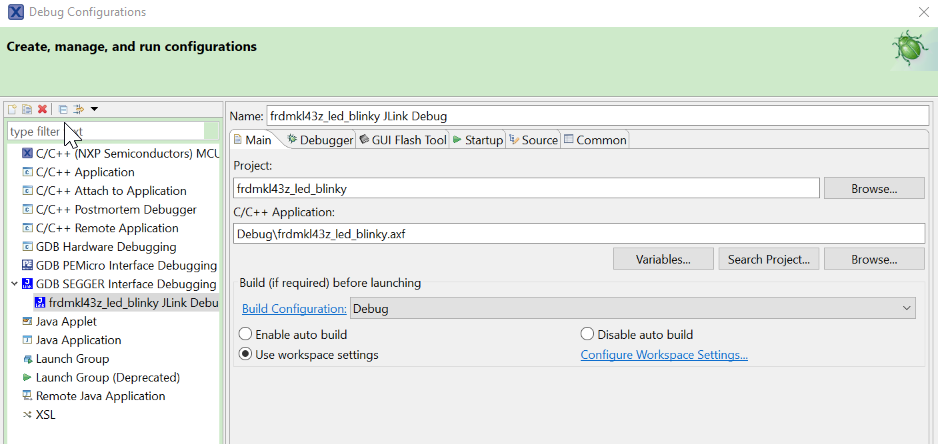

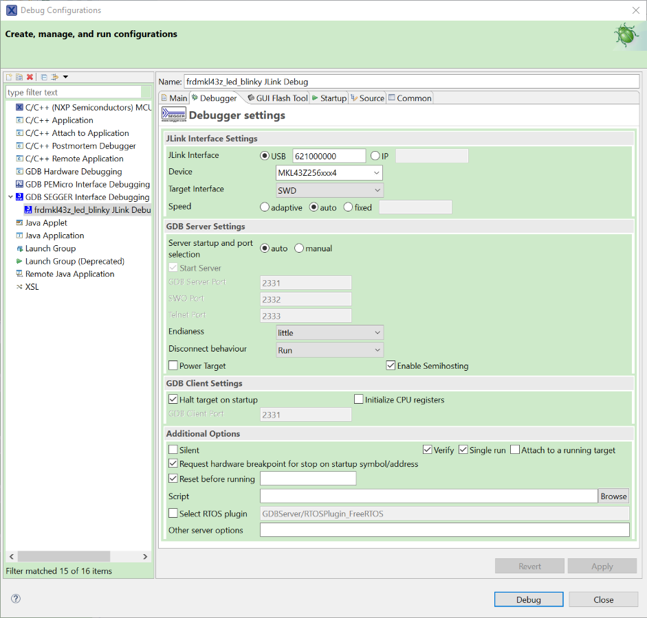

Hui_Ma
Could you post the debug config for double check?
Could you use [GUI Flash Tool] to do [Program] and check if the application works or not?
I do a test with FRDM-KL43Z board and MCUXPresso IDE without any issue.
Mike
17,658 Views
topkinschen
Hi Mike
     I tried build a new KL17 project, but report the same "Break at address ...." error, so it may be my MCUXpresso settings went something wrong.
   use [GUI Flash Tool] to do [Program] report error -1, [erase] also report error -1,[resurrtect locked kinetis device] works.
   you mentioned post the debug config for double check, i don't understand this, where should i snapshot the debug config.
   thanks.
17,658 Views
Hui_Ma
Hi Liang Chen
Please check below pictures to provide debug config info:
BTW: Could you debug the same board with IAR IDE?
best regards,
Mike
17,658 Views

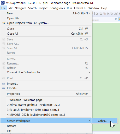

Hui_Ma
Hi Liang,
If you worry about the current workspace [.metadata] folder, I would recommend to create a new folder as new workspace for MCUXpresso IDE software. Then you will get a clear workspace.
Wish it helps.
best regards,
Mike
17,658 Views
topkinschen
Hi  Mike
    I tried: 1 build a new project in a new workspace;2 delete the old [.metadata] folder, restart IDE then build new project. both lead to the same error"break ar address 0x..." when debug with jlink.
17,662 Views
