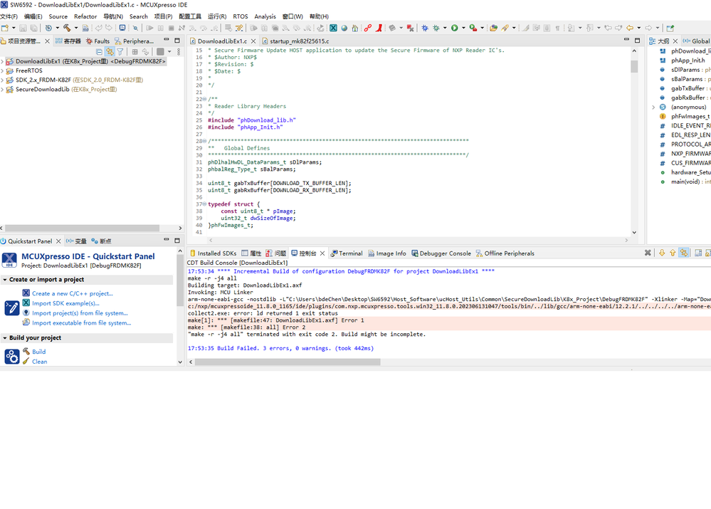

can't built the project DownloadLibEx1 from SW6592

pathbreaker
1.pngin order to restore PNEV5190B to its original state,
I follow the steps of the: PNEV5190B evaluation board quick start guide
But it can't success, when I build the project “DownloadLibEx1”
2,523 Views
lpcxpresso_supp

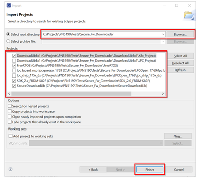

Being a linking error, linker does not find required libraries. I suggest you double check "MCU Linker" section of the build tools settings and make sure the library search paths are OK.
Also, make sure dependencies between projects are correct and you build the required build configurations for needed projects. In your case, maybe DownloadLibEx1 with active build config "debug", refers the library built by "debug" from SDK_2.x_FRDM-K82F. However, you're building "release" target, thus the library you need is not present. It's just an assumption.

lpcxpresso_supp

2,488 Views
pathbreaker
After I changed the path, it can be successfully built. Sincerely thank you!

pathbreaker
Hi,Pavel!
I previously used K82 with an example from NFC READER LIBRARY for software development. In this case, if I want PNEV5190B to be used again with NFC Cockpit, I must reinstall K82 FW later. During the reinstallation process, I referred to section 4.3.2 of this AN12550 manual。
