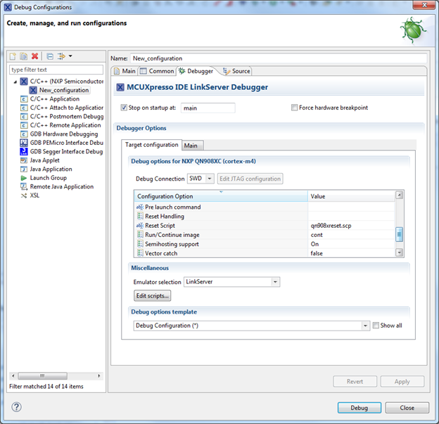

Please include The Debug Log in your response. You stated there were no debug configuration changes to blame, but the  first question I'll ask is whether your launch configuration uses the qn908xreset.scp reset script?

I used the default configuration settings and it appears that I am using the qn908xresect.scp script. Nothing is selected in the Reset Handling field though. Should I have something selected there?
The qn908cdk_wireless_examples_bluetooth_heart_rate_sensor_bm Debug messages console is empty.
Here is the RedlinkServer log:
