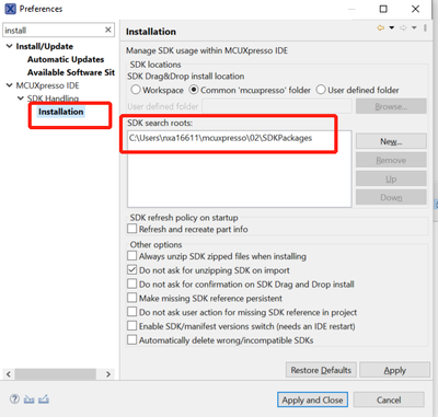

ZhangJennie
Hi abnxpweb
MCUXpresso IDE version must match SDK versions.
In SDK package readme file, we can see which version of IDE is suggested for this versions of IDE.
For a certain version of IDE, I suggest you installing all the supported SDK versions to a defined folder to make sure SDK and IDE versions match.
Hope this helps,
