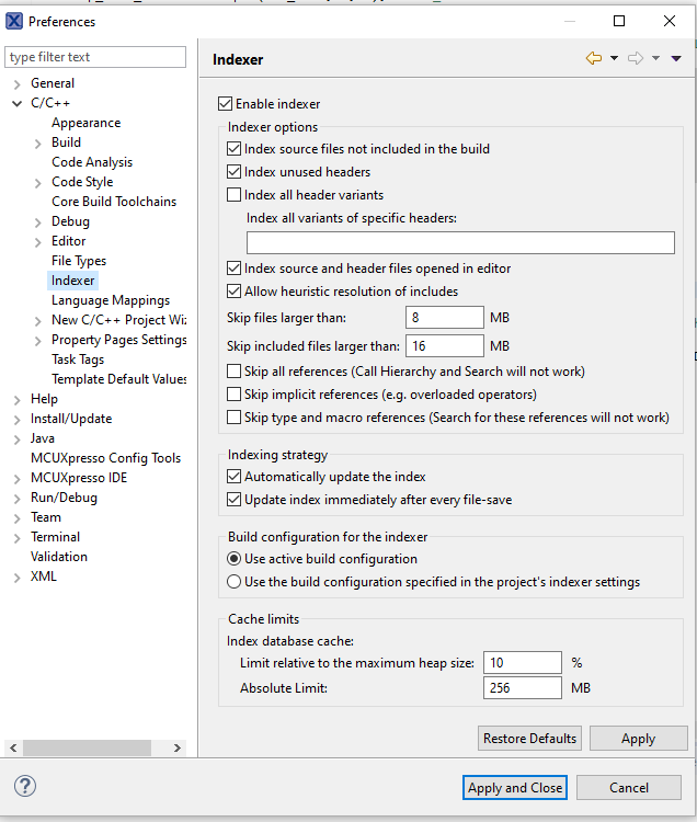

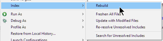

On another thought: that functionality depends on the 'Index', so if you see problems, I recommend to rebuild it:
Additionally, I always disable the 'heuristics' mode for better results, see Fixing the Eclipse Index | MCU on Eclipse  for details.
I hope this helps,
Erich

I right-click on each project  -  Index  -  Rebuild
My indexer window is as follows:
