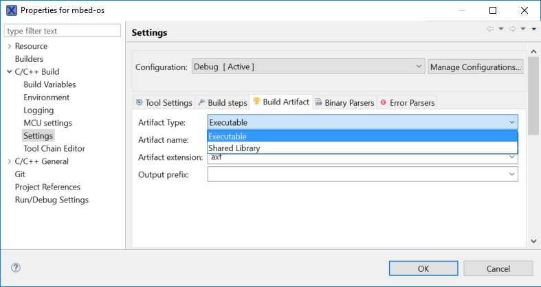

Question is in the title.
I don't see any way to change it in the project options. Would I really have to generate a new project from scratch? Why?
My current use case is that I've exported mbed-os as an MCUXpresso project, and I want to make it a static library. AFAIK, there is no option to export it as a static library project.
When I set it to a Shared Library artifact type, it tries to link everything into a single image, so I don't think that's a workable solution:
Building target: mbed-os.axf
Invoking: MCU C++ Linker
arm-none-eabi-c++ -o "mbed-os.axf" ./targets/TARGET_NXP/TARGET_LPC408X/device/TOOLCHAIN_GCC_ARM/startup_LPC408x.o ./targets/TARGET_NXP/TARGET_LPC408X/device/system_LPC407x_8x_177x_8x.o ./targets/TARGET_NXP/TARGET_LPC408X/TARGET_LPC4088/analogin_api.o ./targets/TARGET_NXP/TARGET_LPC408X/TARGET_LPC4088/can_api.o ./targets/TARGET_NXP/TARGET_LPC408X/TARGET_LPC4088/ethernet_api.o ./targets/TARGET_NXP/TARGET_LPC408X/TARGET_LPC4088/i2c_api.o ./targets/TARGET_NXP/TARGET_LPC408X/TARGET_LPC4088/pwmout_api.o ./targets/TARGET_NXP/TARGET_LPC408X/TARGET_LPC4088/serial_api.o ./targets/TARGET_NXP/TARGET_LPC408X/TARGET_LPC4088/spi_api.o ./targets/TARGET_NXP/TARGET_LPC408X/analogout_api.o ./targets/TARGET_NXP/TARGET_LPC408X/gpio_api.o ./targets/TARGET_NXP/TARGET_LPC408X/gpio_irq_api.o ./targets/TARGET_NXP/TARGET_LPC408X/pinmap.o ./targets/TARGET_NXP/TARGET_LPC408X/port_api.o ./targets/TARGET_NXP/TARGET_LPC408X/rtc_api.o ./targets/TARGET_NXP/TARGET_LPC408X/sleep.o ./targets/TARGET_NXP/TARGET_LPC408X/us_ticker.o ./rtos/TARGET_CORTEX/rtx5/TARGET_RTOS_M4_M7/TOOLCHAIN_GCC/irq_cm4f.o ./rtos/TARGET_CORTEX/rtx5/RTX_Config.o ./rtos/TARGET_CORTEX/rtx5/rt_OsEventObserver.o ./rtos/TARGET_CORTEX/rtx5/rtx_delay.o ./rtos/TARGET_CORTEX/rtx5/rtx_evflags.o ./rtos/TARGET_CORTEX/rtx5/rtx_evr.o ./rtos/TARGET_CORTEX/rtx5/rtx_kernel.o ./rtos/TARGET_CORTEX/rtx5/rtx_lib.o ./rtos/TARGET_CORTEX/rtx5/rtx_memory.o ./rtos/TARGET_CORTEX/rtx5/rtx_mempool.o ./rtos/TARGET_CORTEX/rtx5/rtx_msgqueue.o ./rtos/TARGET_CORTEX/rtx5/rtx_mutex.o ./rtos/TARGET_CORTEX/rtx5/rtx_semaphore.o ./rtos/TARGET_CORTEX/rtx5/rtx_system.o ./rtos/TARGET_CORTEX/rtx5/rtx_thread.o ./rtos/TARGET_CORTEX/rtx5/rtx_timer.o ./rtos/TARGET_CORTEX/rtx4/cmsis_os1.o ./rtos/TARGET_CORTEX/mbed_boot.o ./rtos/TARGET_CORTEX/mbed_rtx_handlers.o ./rtos/TARGET_CORTEX/mbed_rtx_idle.o ./rtos/ConditionVariable.o ./rtos/EventFlags.o ./rtos/Mutex.o ./rtos/RtosTimer.o ./rtos/Semaphore.o ./rtos/Thread.o ./platform/ATCmdParser.o ./platform/CallChain.o ./platform/FileBase.o ./platform/FileHandle.o ./platform/FilePath.o ./platform/FileSystemHandle.o ./platform/LocalFileSystem.o ./platform/Stream.o ./platform/mbed_alloc_wrappers.o ./platform/mbed_application.o ./platform/mbed_assert.o ./platform/mbed_board.o ./platform/mbed_critical.o ./platform/mbed_error.o ./platform/mbed_interface.o ./platform/mbed_mem_trace.o ./platform/mbed_mktime.o ./platform/mbed_poll.o ./platform/mbed_retarget.o ./platform/mbed_rtc_time.o ./platform/mbed_sdk_boot.o ./platform/mbed_semihost_api.o ./platform/mbed_stats.o ./platform/mbed_wait_api_no_rtos.o ./platform/mbed_wait_api_rtos.o ./hal/mbed_flash_api.o ./hal/mbed_gpio.o ./hal/mbed_lp_ticker_api.o ./hal/mbed_pinmap_common.o ./hal/mbed_sleep_manager.o ./hal/mbed_ticker_api.o ./hal/mbed_us_ticker_api.o ./features/netsocket/cellular/generic_modem_driver/OnboardCellularInterface.o ./features/netsocket/cellular/generic_modem_driver/PPPCellularInterface.o ./features/netsocket/cellular/generic_modem_driver/UARTCellularInterface.o ./features/netsocket/NetworkInterface.o ./features/netsocket/NetworkStack.o ./features/netsocket/Socket.o ./features/netsocket/SocketAddress.o ./features/netsocket/TCPServer.o ./features/netsocket/TCPSocket.o ./features/netsocket/UDPSocket.o ./features/netsocket/WiFiAccessPoint.o ./features/netsocket/nsapi_dns.o ./features/mbedtls/src/aes.o ./features/mbedtls/src/aesni.o ./features/mbedtls/src/arc4.o ./features/mbedtls/src/asn1parse.o ./features/mbedtls/src/asn1write.o ./features/mbedtls/src/base64.o ./features/mbedtls/src/bignum.o ./features/mbedtls/src/blowfish.o ./features/mbedtls/src/camellia.o ./features/mbedtls/src/ccm.o ./features/mbedtls/src/certs.o ./features/mbedtls/src/cipher.o ./features/mbedtls/src/cipher_wrap.o ./features/mbedtls/src/cmac.o ./features/mbedtls/src/ctr_drbg.o ./features/mbedtls/src/debug.o ./features/mbedtls/src/des.o ./features/mbedtls/src/dhm.o ./features/mbedtls/src/ecdh.o ./features/mbedtls/src/ecdsa.o ./features/mbedtls/src/ecjpake.o ./features/mbedtls/src/ecp.o ./features/mbedtls/src/ecp_curves.o ./features/mbedtls/src/entropy.o ./features/mbedtls/src/entropy_poll.o ./features/mbedtls/src/error.o ./features/mbedtls/src/gcm.o ./features/mbedtls/src/havege.o ./features/mbedtls/src/hmac_drbg.o ./features/mbedtls/src/md.o ./features/mbedtls/src/md2.o ./features/mbedtls/src/md4.o ./features/mbedtls/src/md5.o ./features/mbedtls/src/md_wrap.o ./features/mbedtls/src/memory_buffer_alloc.o ./features/mbedtls/src/net_sockets.o ./features/mbedtls/src/oid.o ./features/mbedtls/src/padlock.o ./features/mbedtls/src/pem.o ./features/mbedtls/src/pk.o ./features/mbedtls/src/pk_wrap.o ./features/mbedtls/src/pkcs11.o ./features/mbedtls/src/pkcs12.o ./features/mbedtls/src/pkcs5.o ./features/mbedtls/src/pkparse.o ./features/mbedtls/src/pkwrite.o ./features/mbedtls/src/platform.o ./features/mbedtls/src/ripemd160.o ./features/mbedtls/src/rsa.o ./features/mbedtls/src/sha1.o ./features/mbedtls/src/sha256.o ./features/mbedtls/src/sha512.o ./features/mbedtls/src/ssl_cache.o ./features/mbedtls/src/ssl_ciphersuites.o ./features/mbedtls/src/ssl_cli.o ./features/mbedtls/src/ssl_cookie.o ./features/mbedtls/src/ssl_srv.o ./features/mbedtls/src/ssl_ticket.o ./features/mbedtls/src/ssl_tls.o ./features/mbedtls/src/threading.o ./features/mbedtls/src/timing.o ./features/mbedtls/src/version.o ./features/mbedtls/src/version_features.o ./features/mbedtls/src/x509.o ./features/mbedtls/src/x509_create.o ./features/mbedtls/src/x509_crl.o ./features/mbedtls/src/x509_crt.o ./features/mbedtls/src/x509_csr.o ./features/mbedtls/src/x509write_crt.o ./features/mbedtls/src/x509write_csr.o ./features/mbedtls/src/xtea.o ./features/mbedtls/platform/src/mbed_trng.o ./features/frameworks/utest/source/unity_handler.o ./features/frameworks/utest/source/utest_case.o ./features/frameworks/utest/source/utest_default_handlers.o ./features/frameworks/utest/source/utest_greentea_handlers.o ./features/frameworks/utest/source/utest_harness.o ./features/frameworks/utest/source/utest_shim.o ./features/frameworks/utest/source/utest_stack_trace.o ./features/frameworks/utest/source/utest_types.o ./features/frameworks/utest/mbed-utest-shim.o ./features/frameworks/unity/source/unity.o ./features/frameworks/greentea-client/source/greentea_metrics.o ./features/frameworks/greentea-client/source/greentea_serial.o ./features/frameworks/greentea-client/source/greentea_test_env.o ./features/filesystem/fat/ChaN/ccsbcs.o ./features/filesystem/fat/ChaN/ff.o ./features/filesystem/fat/FATFileSystem.o ./features/filesystem/bd/ChainingBlockDevice.o ./features/filesystem/bd/HeapBlockDevice.o ./features/filesystem/bd/MBRBlockDevice.o ./features/filesystem/bd/ProfilingBlockDevice.o ./features/filesystem/bd/SlicingBlockDevice.o ./features/filesystem/Dir.o ./features/filesystem/File.o ./features/filesystem/FileSystem.o ./events/equeue/equeue.o ./events/equeue/equeue_mbed.o ./events/equeue/equeue_posix.o ./events/EventQueue.o ./events/mbed_shared_queues.o ./drivers/AnalogIn.o ./drivers/BusIn.o ./drivers/BusInOut.o ./drivers/BusOut.o ./drivers/CAN.o ./drivers/Ethernet.o ./drivers/FlashIAP.o ./drivers/I2C.o ./drivers/I2CSlave.o ./drivers/InterruptIn.o ./drivers/InterruptManager.o ./drivers/RawSerial.o ./drivers/SPI.o ./drivers/SPISlave.o ./drivers/Serial.o ./drivers/SerialBase.o ./drivers/Ticker.o ./drivers/Timeout.o ./drivers/Timer.o ./drivers/TimerEvent.o ./drivers/UARTSerial.o -lstdc++ -lsupc++ -lm -lc -lgcc -lnosys -DMBED_DEBUG -DMBED_TRAP_ERRORS_ENABLED=1 -Wl,-n -Wl,--start-group -lstdc++ -lsupc++ -lm -lc -lgcc -lnosys -Wl,--end-group -Xlinker -Map="mbed-os.map" -Xlinker -print-memory-usage -Xlinker --gc-sections -Xlinker --wrap=main -Xlinker --wrap=_malloc_r -Xlinker --wrap=_free_r -Xlinker --wrap=_realloc_r -Xlinker --wrap=_memalign_r -Xlinker --wrap=_calloc_r -Xlinker --wrap=exit -Xlinker --wrap=atexit -shared -mcpu=cortex-m4 -mfpu=fpv4-sp-d16 -mfloat-abi=softfp -mthumb -T C:/Users/bmcdonnell/Documents/MCUXpressoIDE_10.0.2_411/workspace/mbed-os/Debug/linker-script-debug.ld
c:/nxp/mcuxpressoide_10.0.2_411/ide/tools/bin/../lib/gcc/arm-none-eabi/5.4.1/../../../../arm-none-eabi/bin/ld.exe: mbed-os.axf section `.dynstr' will not fit in region `FLASH'
c:/nxp/mcuxpressoide_10.0.2_411/ide/tools/bin/../lib/gcc/arm-none-eabi/5.4.1/../../../../arm-none-eabi/bin/ld.exe: section .dynsym loaded at [00066c64,000715e3] overlaps section .data loaded at [00066c64,000678b7]
c:/nxp/mcuxpressoide_10.0.2_411/ide/tools/bin/../lib/gcc/arm-none-eabi/5.4.1/../../../../arm-none-eabi/bin/ld.exe: section .dynamic loaded at [000678b8,0006795f] overlaps section .dynsym loaded at [00066c64,000715e3]
c:/nxp/mcuxpressoide_10.0.2_411/ide/tools/bin/../lib/gcc/arm-none-eabi/5.4.1/../../../../arm-none-eabi/bin/ld.exe: region `FLASH' overflowed by 67708 bytes
c:/nxp/mcuxpressoide_10.0.2_411/ide/tools/bin/../lib/gcc/arm-none-eabi/5.4.1/../../../../arm-none-eabi/bin/ld.exe: error: required section '.rel.plt' not found in the linker script
c:/nxp/mcuxpressoide_10.0.2_411/ide/tools/bin/../lib/gcc/arm-none-eabi/5.4.1/../../../../arm-none-eabi/bin/ld.exe: final link failed: Invalid operation
collect2.exe: error: ld returned 1 exit status
make: *** [mbed-os.axf] Error 1
12:30:08 Build Finished (took 17m:44s.626ms)

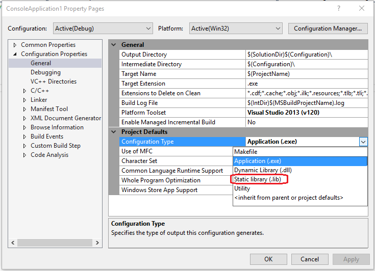

Indeed, I am pursuing that. But I figured project conversion could've been a reasonable work-around. It is a feature that I've observed in other IDEs, such as Visual Studio (pictured below).
