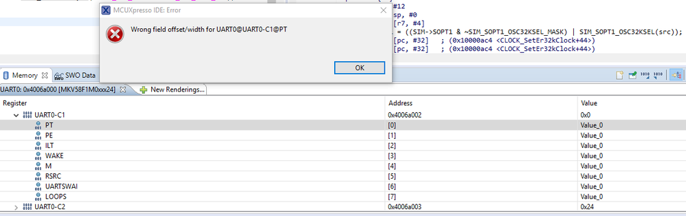

With MCUXpresso IDE 10.0.0 and board TWR_KV58F220M, Debugging with PEmicro OpenSDA.
I'm in debug mode, I have stopped the cpu.
In the "Peripheral +" window I select a peripheral (for example, UART0), immediately in the "Memory" window all the registers associated with that peripheral appear with the ability to SEE the values of those registers.
I select a register (for example UART0_C1[PT]), on the right side I see "Value_0": ok it's the register value.
I click on "Value_0" and the selection of possible values appears, I select "Value_1" to change the value of that register from 0 to 1: immediately the register closes but the value does not change. If I control the log value, it has remained as "Value_0" previously.
In MCUXpresso how can I change the value of registers during debugging?

andreacanepa
Hi Carlos,
Surely the UART0 clock is enabled: it is communicating with FreeMaster. Unless when the MCU goes into Debug mode it turns off the clock. It could be?
Yesterday I installed MCUXpresso 10.0.2 (I did not notice the new release) and did the same test; this time the result is different, an error window is also displayed:
Obviously, I can not change the registry value.
I try to change also the register MCG_C6[LOLIE0] from Value_0 to Value_1: I have the same problem!
I have the impression that the logs are locked in writing. Is there some protection that might be active?

lpcxpresso_supp
Sorry for the problems you are seeing with using the Peripheral Register view.
We've replicated the "Wrong field offset" issue, which is triggered when trying to edit fields within a peripheral register.  We'll investigate fixing this for the next IDE release (currently expected towards the end of November).
You should be able to workaround in the meantime by editing at the register level (rather than at the bitfield level) or by using CMSIS-DAP probe firmware.

andreacanepa
Yes, I've verified that I can change the values directly at the register level.
But I did not understand what you meant with "...or by using CMSIS-DAP probe firmware".
In my card there is PEmicro OpenSDA installed. Do I have to replace it to use the bit access?
