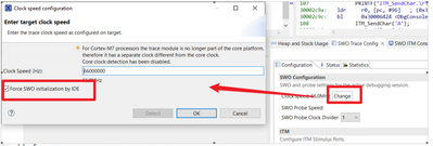

If "Force SWO initialization by IDE" checkbox is checked in MCUXpresso IDE,
the SWO signal is output from PB3 of the MIMXRT1170-EVK board.
But if I perform the same operations displayed on the Trace Console using my code, nothing is output on the SWO signal from PB3 of the MIMXRT1170-EVK board.
This is the output from the console:

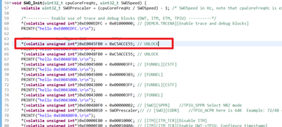

This is my code in which I am performing the same operations:
void SWO_Init(uint32_t cpuCoreFreqHz, uint32_t SWOSpeed)
// SWOSpeed in Hz, note that cpuCoreFreqHz is expected to be match the CPU core clock
volatile uint32_t SWOPrescaler = (cpuCoreFreqHz / SWOSpeed) - 1;
// Enable use of trace and debug blocks (DWT, ITM, ETM, TPIU)
*(volatile unsigned int*)0xE000EDFC = 0x01000000; // [DEMCR.TRCENA][Enable trace and debug blocks]
*(volatile unsigned int*)0xE0045FB0 = 0xC5ACCE55; // UNLOCK
*(volatile unsigned int*)0xE0048FB0 = 0xC5ACCE55; // UNLOCK
*(volatile unsigned int*)0xE0045000 = 0x000003FF; // [FUNNEL][CSTF]
*(volatile unsigned int*)0xE0045000 = 0x00000303; // [FUNNEL]
*(volatile unsigned int*)0xE0043000 = 0x000003FF; // [FUNNEL][CSTF]
*(volatile unsigned int*)0xE00480F0 = 0x00000002; // [SWO][SPPR] //TPIU_SPPR Select NRZ mode
*(volatile unsigned int*)0xE0048010 = SWOPrescaler;// // [SWO][CODR] //TPIU_ACPR here is 64K Example: 72/48 = 1,5 MHz 0x0000000A;
*(volatile unsigned int*)0xE0000E80 = 0x0001000C; // [ITM][ITM_TCR][Disable ITM]
*(volatile unsigned int*)0xE0000E80 = 0x0001040A; // [ITM][ITM_TCR][Enable DWT->TPIU. Configure timestamp]
*(volatile unsigned int*)0xE0000E80 = 0x0001040B; // [ITM][ITM_TCR][Enable ITM block]
*(volatile unsigned int*)0xE0000E00 = 0x00000001; // [ITM][ITM_TER][Enable stimulus ports]
*(volatile unsigned int*)0xE0000E80 = 0x0001040A; // [ITM][ITM_TCR][Disable ITM]
*(volatile unsigned int*)0xE0000E40 = 0x00000008; // [ITM][ITM_TPR][Set privileges]
I would appreciate any help in this matter.

3,425 Views
ConstYu
Hi @ErichStyger
I checked my clocking and pin mux, didn't find any obvious error, my clock configure is as below, while pin mux should be right, as ITM can work well when use the SWO configure tool to output string.
My code still crashed when access 0Xe0045fb0 when not in debug mode, while runs OK when code runs in debug mode, so MCUXPRESSO may have some additional step, really don’t know which step is missing in this code.
In MCXpresso, it have a option to select “force SWO initialization by IDE“  in below figure1, but I didn’t find what MCXpresso will do when check this option, this option is very important.

Hi @ConstYu ,
The IDE should have reported what it does this in the console, as noted in my previous reply.
Erich

I make some debug, found MCU crashed when operate 0xE0045000 address.
below is the initial code I am using, could you help give some advice or make a verify, I suspect there is some initial step is missing.  and there is a RT117X errata called ERR050708: Debug: CoreSight components are not linked to CoreSight ROM table, not sure how we fix it in MCUXpresso.
Thanks in advance.
void SWOOUT_Init(uint32_t cpuCoreFreqHz, uint32_t SWOSpeed) {
volatile uint32_t SWOPrescaler = (cpuCoreFreqHz / SWOSpeed) - 1; /* SWOSpeed in Hz, note that cpuCoreFreqHz is expected to be match the CPU core clock */
/*---------- Enable use of trace and debug blocks (DWT, ITM, ETM, TPIU) ----------*/
PRINTF("hello world11.\r\n");
/***---------- Configure SWO ----------***/
PRINTF("hello world111.\r\n");
PRINTF("hello world1222.\r\n");
PRINTF("hello world333.\r\n");
PRINTF("hello world12.\r\n");
PRINTF("hello world13.\r\n");
PRINTF("hello world14.\r\n");
/***---------- Enable ITM_TRACE ----------***/
PRINTF("hello world15.\r\n");
