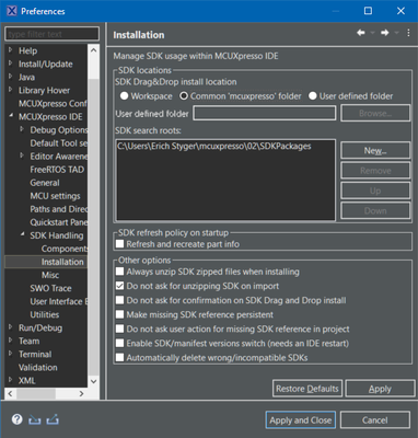

Check the SDK preferences:
And it should show you the SDK location:
Can you check this?

Took a look at the SDK location the way you described. -> both installs have exact the same path and all settings are exact the same as the ones in your picture. The only difference is of course my username is different.
