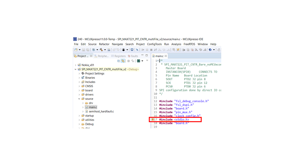

Unresolved inclusion: <stdio.h>

While importing project from MCUXpresso 10.3.1 to new IDE v. 11.0.0
I got question mark  ? Unresolved inclusion: <stdio.h>

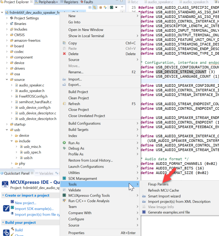

lpcxpresso_supp
Using the Tools->Fixup Parsers option on the Project Properties view's context sensitive menu (with the affect project selected) should resolve this issue for you.
[ This issue is described in the release info at: MCUXpresso IDE v11.0.0 Now Available ]

Can you be more specific I can't fined
In Project Properties view's.
Where this issue is described in release info exactly?

Alexis_A
Hi shauldorf‌,
You can find it here:

From yours screen I don't know to which menu his "Tools" belongs.
I'm not familiar with Eclipse perspective options and I'm using standard Menu Bar.

BlackNight
Hi Shaul,
it is in the context menu: select your project, then mouse right-click on it to get the menu.
I hope this helps,
Erich
