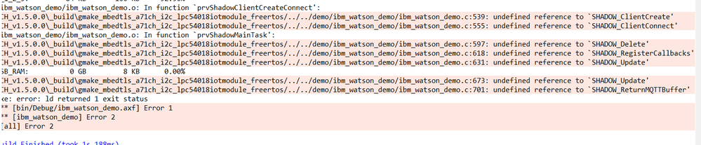

    I am working on LPC54018 board. I have two different software stacks in MCU xpresso
1. One using a71ch with IBM watson platform
2.Second using LPC iot module with Alexa
Both projects are working successfully when I test them independently. I wanted to integrate them. I was able to do it almost but there is a place when I am not able to proceed further.
I have two files aws_shadow.h and its corresponding aws_shadow.c files. I need to call them in my main.c file in the function void prvShadowMainTask(void *pvParameters).
I made the code changes inside ibm_watsin_demo.c which holds the main() and when I try to navigate to SHADOW_Delete() function and other shadow functions, I am able to. But when I build my project , they are throwing me an error like below:
I have added the amazon-freertos folder which holds all the required files. But I am not able to map it in a right way.
Is there any declaration or initialization function/file I am missing over here?
Any pointers would be helpful.

BlackNight
1): the problem is that the project is not setup to be moved around (or copied into a different place), because the paths are relative to your project location. You would have to change the include paths or copy the extra files.
2) I suggest you check the console view and check the object files passed to the linker. Is the file with your Shadow functions passed to the linker?

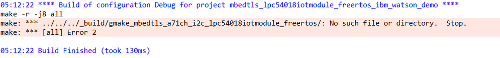

trialaccount12
Contributor V
    Thank you for your reply.

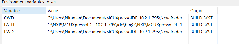

Yes, I tried what you mentioned above. Strangely it did not work.! I also noticed one thing, the zip file which I have attached above works only in one workspace of MCU. If I import it again into a different workspace, this below error:
Now I do have two questions here.
1. Why does this above behavior occur? I guess this is the reason why you were not able to run the project. Because all the files are there and it is working fine but only in one workspace. Is it because of "CWD path" below??:
2. Coming back to my original post, I do want to use shadow functions in my code. Any other approaches?(since exclude from build was not the issue I realized after checking)

BlackNight

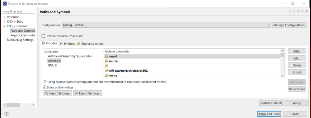

trialaccount12
Contributor V
    1. Yes, I will change the location
    2. I checked it. It is getting passed to the linker function. But when I compare the properties of the amazon-freertos folder, this contains the shadow h and c files with the original project and my project, there is a difference in "includes" section. I did not see any copy/paste function to add files into includes.
In my integrated project:
The original project:
Is it possible to port the input functions?
Any documents / pointers would be helpful.
