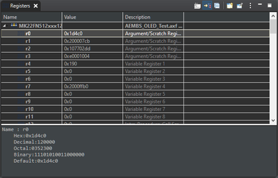

I'm new to MCUXpresso and just realized that I cannot see any of the registers under the "Registers" tab.
I'm using MCUXpresso 11.2.1 and am connected to my Kinetis MCU and can step through the code nicely, "Heap ands Stack Usage" for example get updated nicely but the Registers tab is just empty, no matter if "Show modified registers only" is checked or not.
How can I get the controller's registers to show?

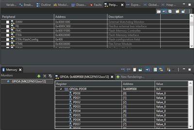

In general: The core registers only get updated/displayed in the debugger if the target is halted:
The reason is that on the ARM Cortex M it is only possible to read the core register if the processor is halted.
Just in case if you are interested in the peripheral registers, they are shown in the Peripheral+ (plus Memory view):

Awesome, so turns out that there apparently is two registers cards for Registers, and I was initially looking at the wrong one but once I pulled up the other one along with the Peripherals+ from  Window -> Show View -> Peripherals+ I can see the register values as I expected! Awesome! Thank you!

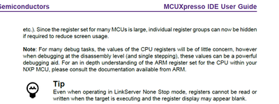

Please note : when operating in LinkerServer None Stop mode, registers cannot  be read or written when the target is executing and the register display may appear blank.
Please refer to MCUXpresso_IDE_User_Guide.pdf   , 11.6 Registers for more details.
