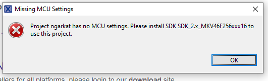

I am unable to build my code for MKV46F256 controller. I have installed the required packages but still its not happening and i am getting the error
" Project 'Project name' has no MCU setting. Please install SDK SDK_2.x_MKV46F256xxx16 to use this project".
What to do ???

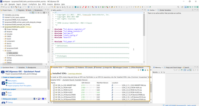

Regarding your issue, please make sure that you downloaded the full SDK (zip folder) for KV46 from here: https://mcuxpresso.nxp.com/en/select
And then, please be sure that you dragged and dropped the zip folder right here on your MCUXpresso IDE and you have correctly installed the SDK for that MCU:
If the problem persists, please let me know your comments or if you have more questions.
