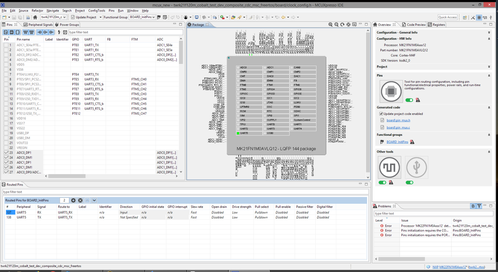

I'm able to use the clocks tool to configure the project for the 12 MHz crystal my board uses, and with that set properly I'm at least able to boot and enumerate.  If I go into the pins tool, though, I see that the 64 LQFP package isn't available on this variant.  Changing to any variant gives me a warning that the processor type doesn't match, and I can't find where it expects that to be changed.  I get more errors if I go into the project settings and change the MCU type there.

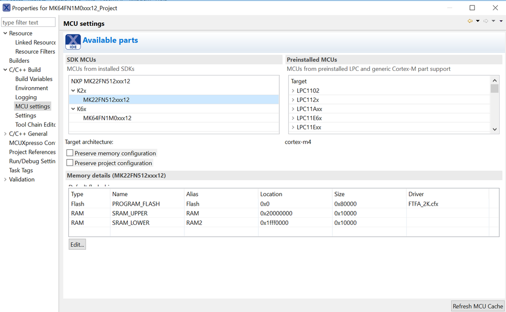

MCUXpresso IDE has setting to change MCU, see

That doesn't seem to affect the pins tool, other than to make it display an error about a part mismatch:
As you can see, it's still only letting me choose from packages for the MK21FN.  How do I switch the configuration utilities to the right MCU?

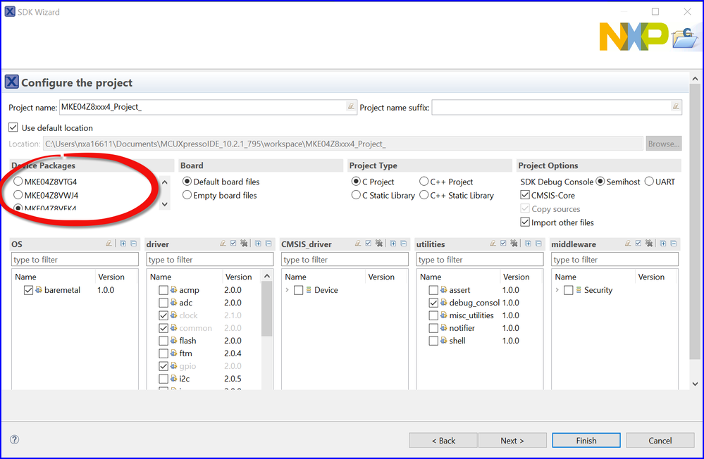

User can choose device packages during creating a new project. see below:
But There is no user interface to change Device package for an existing project. My colleague has reported this issue. I will let you know if we get update.

There is no way of changing MCU package for an existing project or for importing sdk demos under 10.2.1.
"this functionality will be available in the next release of the IDE 10.3.0 available in December."

Currently for MCUXpresso IDE 10.2.1, as this package changing feature is not added. User has to create a new project with the package you need, then manually add the code from samples.
Next moth when 10.3 releases, this will be easy.

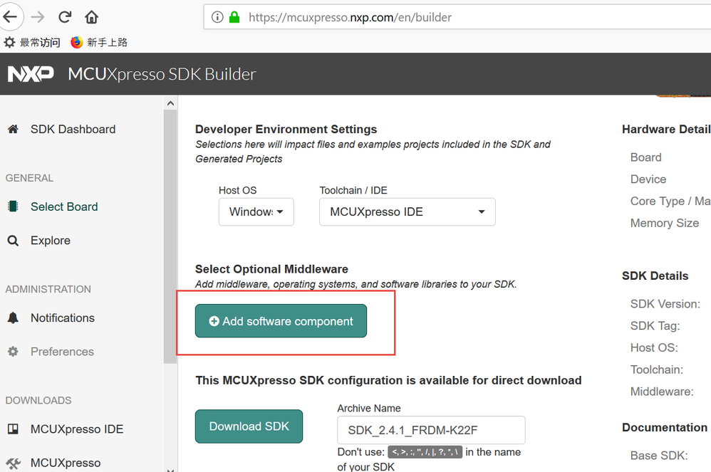

You can check this table for the recommend SW IDE/SDK
MCUXpresso Supported Devices Table - through May 2018
according to this table, k22F is recommended to use MCUXpresso IDE and SDK.
before download SDK, if you want to use USB, add USB component. download SDK. SDK package will include USB demos.
