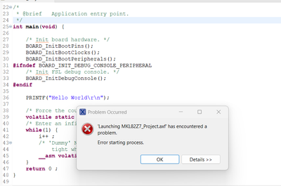

I'm new to MCUXpresso IDE and im trying to upload a hello world sketch to my Kinetis KL82.  I successfully installed the SDK for the board from MCUXpresso SDK Builder. I then built the Hello world sketch, and it built with no errors but when I tried running it I got this error:
I was using this tutorial as a reference: How to Install MCUXpresso IDE | NXP| Getting started with FRDM-KL25Z - YouTube
I'm on a Dell XPS 17 which doesn't have any USB ports, so I used a USB-to-USB-c converter to connect to my board. I went to the device manager to see if it says the device is connected and it said it was connected, plus when I connected a wireless mouse to the converter, the mouse worked perfectly fine. So, I've eliminated that being the error. What could be the error here?

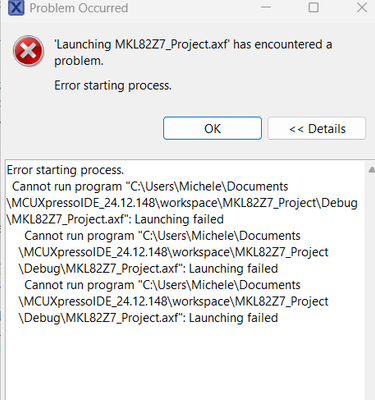

Where can I check to see if the LinkServer pack is installed? Heres the further details of the error:
I believe it just showed the directory to the program.

From your screenshot, I suspect you're not using any of the debug solutions supported by MCUXpresso IDE. I think you manually created a Run/Debug configuration that tries to execute the ELF on the host OS.
Please use the blue bug button in the the IDE's toolbar or use the Debug button from the Quickstart Panel to start a debug session. You should have a LinkServer, J-Link or PEmicro debug configuration created based on your selected probe. Make sure you delete all the previously created debug configurations from your project to make sure that they are recreated by the IDE.

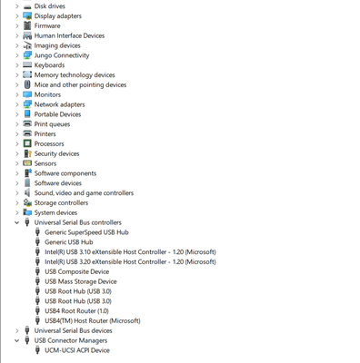

Tyler5638
So I tried this again with the USB-to-USB-c converter on the laptop that I was using before that does not have a USB port and it recogonized the USB port.

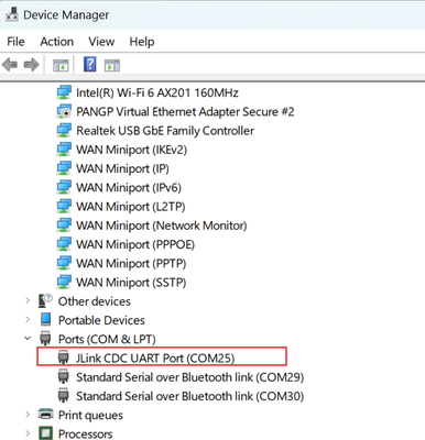

Hello @Tyler5638
Please confirm to connect the J5 port (SDA USB). The device manager should recognize the corresponding port as follows:
