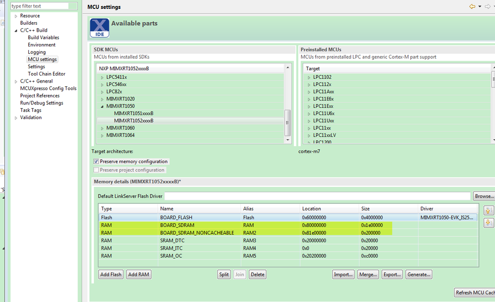

1. define XIP_BOOT_HEADER_DCD_ENABLE
2. define SKIP_SYSCLK_INIT
3. separate the NONCACHEBLE region for the usb buffer.

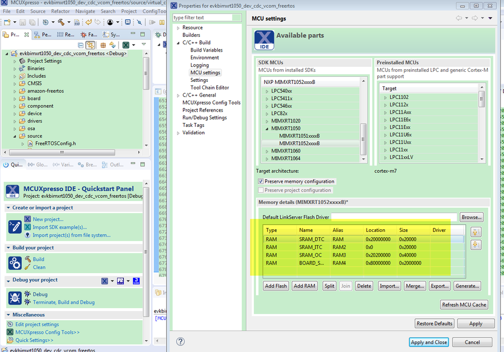

    Could you give me your memory details? Like this picture, I will check it on my side.
Kerry

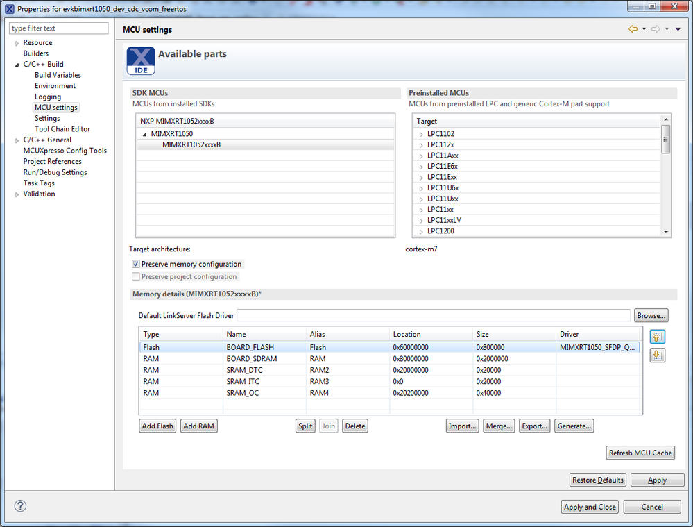

henrique_klein
Hello Kerry,
My configuration was just as yours, but I changed the ram order:
I didn't change anything else, except for QSPI XIP, because I already changed my board to boot from there.
Once again, thank you for reply.

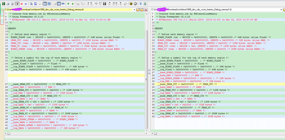

      I have checked it on my side, actually, it is not only in the usb sample code, even the iled_blinky code, if you modify the SDRAM instead of the DTC, it also have problems.
     I have compared the two link filer:
   the __base_RAM have the difference, it seems the basic RAM can't use the SDRAM, I will check it from our internal side, then give you reply later.
