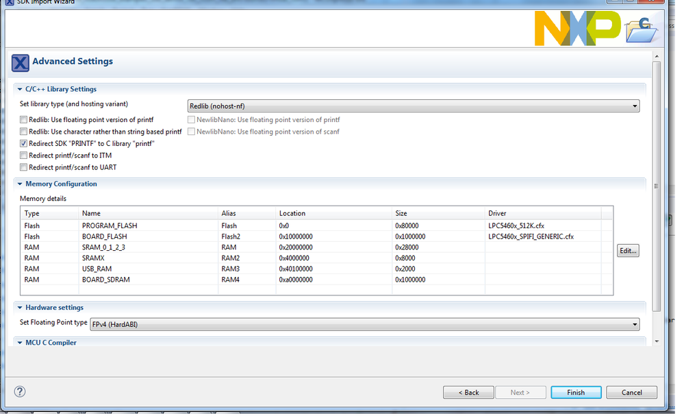

I would like to ask if somebody tried an examples USB  - SDK_2.2_LPCXpresso54608.zip?
I tried boards\lpcxpresso54608\usb_examples\usb_device_cdc_vcom and boards\lpcxpresso54608\usb_examples\usb_host_hid_mouse and these examples doesn't work...I use LPCexpresso V10.

I suspect that when you import the project, you have semihosting output enabled (so that printf, for example, is displayed into the IDE's debugger console view). If you then try to execute the application other than via the debugger then the semihosting operation will fail and cause the application to enter the hard fault handler. This may well prevent your application reaching the point where USB is enabled - hence why you might not be seeing the vcom port.
See the supplied MCUXpresso IDE v10.0.2 User Guide for more details, with good places to start being:
  • Section 6.1.1, "SDK Example Import Wizard: Basic Selection" (and note the check box indicated by "4" in figure 6.3.)
  • Section 11.4, "What is Semihosting"

I resolved the problem:smileyhappy:
 And I think, that for the character sending has to use: usb_echo function. But then I did debug and I found, that I have to use another mechanism:
while (1)
APPTask();
s_sendSize = 3;
s_currSendBuf[0] = 'A';
s_currSendBuf[1] = 'A';
s_currSendBuf[2] = 'A';
And it works:)
I think, that SDK examples needs one example with a basic function for users, which are moving on LPC546xx from lower series...
Thx
