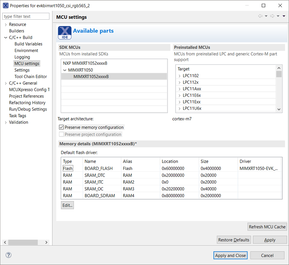

This is my MCU settings:

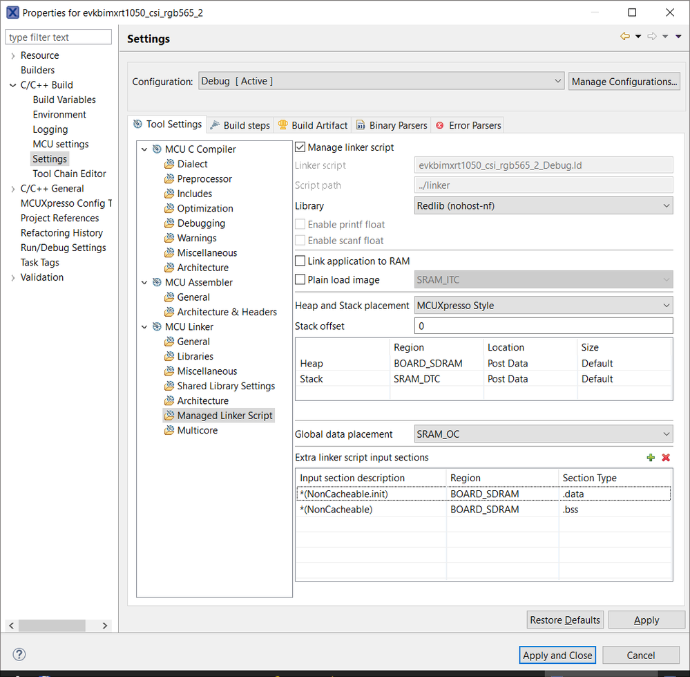

This is my managed linker script configuration:

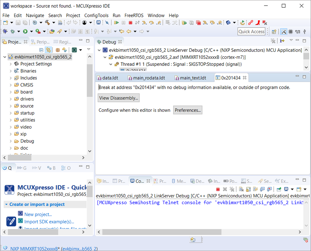

But after I upload program binary it to my IMXRT1050-EVKB board it stop with this error:
What I am doing wrong?
If I use the same configuration but without this:
<#if memory.alias=="RAM2">
        *(.text*)
        . = ALIGN(${text_align});
</#if>‍‍‍‍‍‍‍‍
Then it is working. So, the only problem is ITC memory, rest of my memory layout seems to be functional.
In original linker script file "MIMXRT1052xxxxx_flexspi_nor.ld" is the SDRAM memory splited into two regions. First have 30MB and second 2MB. Camera RGB565 buffer is in smaller 2MB region.
Why is SDRAM splitted into two regions?

lpcxpresso_supp
So the main issue here is that the function SystemInit() which called from near the start of the reset handler is being relocated into RAM, but is called before the copy from flash to RAM takes place (so the code isn't actually in the RAM yet to excute).
You can fix this by changing main_text.ldt and main_rodata.ldt such that SystemInit() is left to run from flash, thus:
main_text.ldt:
*startup_*.o (.text.*)
*system_*.o (.text.*)
*(.text.main)
*(.text.__main)
main_rodata.ldt:
*startup_*.o (.rodata .rodata.* .constdata .constdata.*)
*system_*.o (.rodata .rodata.* .constdata .constdata.*)
After making this change, do a full clean before then doing a build - to make sure that the changes to the template files are picked up by the managed linker script system (and you might want to check the generate .ld files afterwards - just to make sure).
I would also suggest mass erasing the flash and powering the board down and back up again before debugging the rebuilt project.

pjanco
It is working!
Thanks!

The reason that SDRAM is probably split in two is because the two sections are set up different in the MPU settings (one part cached, the other not cached).

- "Why is SDRAM splitted into two regions?" -> Use a stand alone space placing the two buffers
"s_cameraBuffer" and "s_lcdBuffer".
