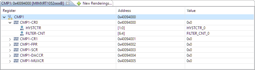

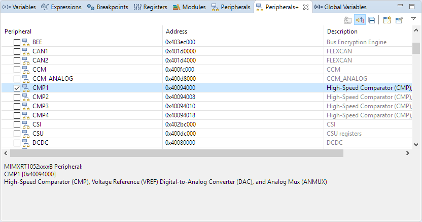

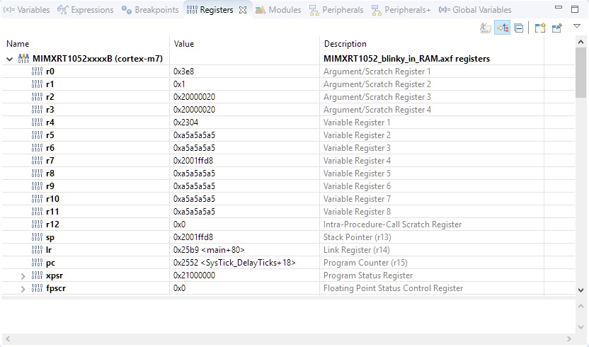

I don't have a 1020 at hand, so here with the 1051 which is the same for the 1020:
Core registers:
Peripherals+:
which uses a memory rendering:
I hope this helps,

Although the register view was grayed out in the Windows -> Show View -> Other-> Debug -> Registers menu I could still click on it and then both the CPU register and Peripherals appeared.
Then I closed the two windows and the Register entry in the menu was no longer grayed out so I could re-enable the register view again normally (but it didn't this time switch in the Peripherals too).
I needed to search to re-enable the peripheral view since it is in Windows -> Show View -> Other->MCUXpresso IDE -> Peripherals+ instead.
