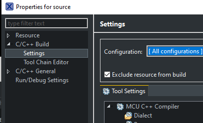

Another issue is that every time I do 'Refresh SDK', some folders end up as excluded from build. I manually have to include them again.

for issue 1 and 4: there is Component Manager capable to update source files for components selected in the project. Try to open Component Manager and update new configuration. This could help.
