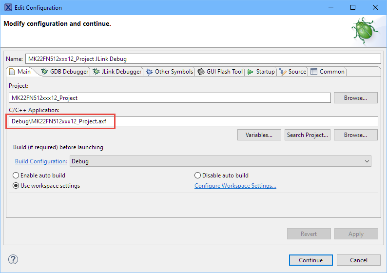

They use Gcc to compile code and generate .elf, .map, .hex files, they want to know whether MCUXPRESSO IDE could compatitable these format and debug this elf file?
If yes, please show procedures, thanks.

Yes, you can do this:
a) create a project for that device in the IDE
b) in the debug configuration, use your .elf file instead:
