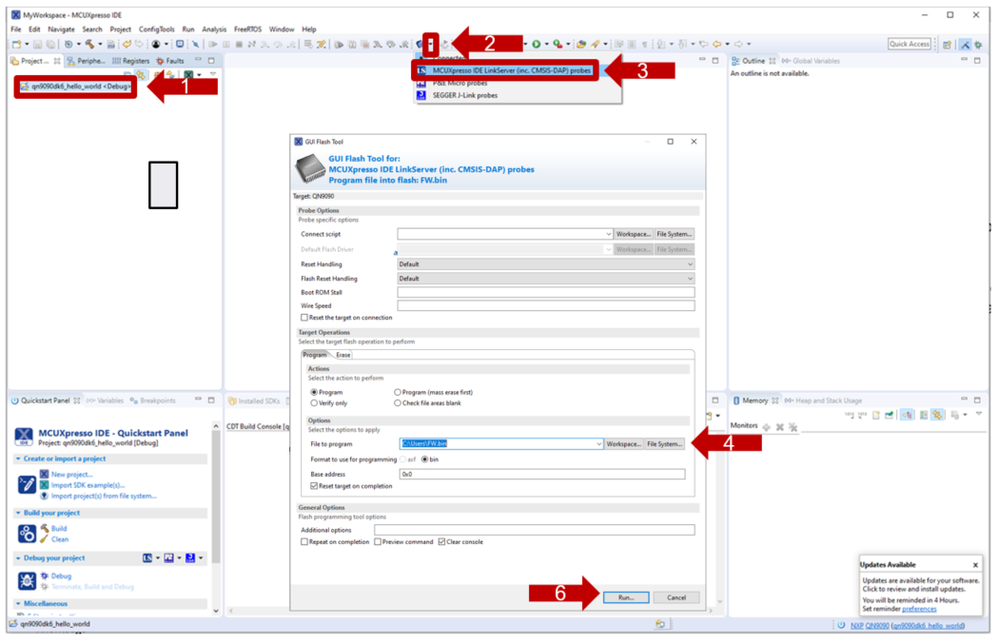

I am trying to Flahs Binary to QN9090 using LPC-link2.
An error message is output and flashing is not possible.
I need help.
I don't know what is matter.
i attached imaga.
MCUXpressoIDE version : MCUXpressolIDE_11.0.1_2563
SDK : SDK_2.6.0_QN9090
Use to 'GUI_FLASH_TOOL'

Hi  Seungyeob Yi,
I hope you are doing great.
I tested by mi side and it works. I am assuming that your FW.bin file is for the QN9090, however, you are accessing from the User folder, so maybe the MCUxpresso doesn't have the privileges for access to that path.
Just to confirm, did you add the patch for this device?
QN9090 ROM Patch Update V5
