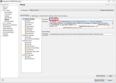

I'm facing a problem with MCUXpresso 11.9.1.
For some reasons in building my project I need to do some other things when I compile, so I created a script that do all I need (build + other things).
In the MCU C Compiler section I set my script as command builder. The script is located in the same folder as the project:
My scripts is working fine: when I build my project using the external builder, every project file is built using my script and the linker process is executed fine.
The problem arises when I need to build a single file: I launch the Build Selected File(s) command and I receive some error messages.

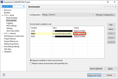

Reading the error message I've found that the script folder wasn't in the PATH. So I modified the PATH environment variable to include that folder:
With these settings I receive a different message:
Info: Internal Builder is used for build
"C:\\...\\MIMXRT1064_Project\\mybuild.sh" -D__REDLIB__ [...] -o "source\\MIMXRT1064_Project.o" "..\\source\\MIMXRT1064_Project.c"
Cannot run program "C:\...\MIMXRT1064_Project\mybuild.sh": Launching failed
