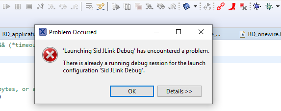

I have a LPCXpresso824-MAX board and i am just starting to play with MCU Expresso with this board.
Often the IDE gets in a state where i try and re-download an app and debug, and the IDE complains "There is already a running debug session for the launch configuration '...'."
The target is running, usually because i remove the last breakpoint and say "Resume", and you can see its running, for example blinky will be blinking its LED,  but there is no way to terminate. The terminate Button is greyed out.  Even the "Terminate, Build and Debug '...'" command fails with the same error.
The only way I have found out of this is the shutdown MCUExpresso and restart it, which doesn't feel very robust.  I am just playing now, but if i was developing serious code this would be a very annoying scenario.  So am i doing something wrong?  Is there a hidden way to terminate a running app that im not seeing?

Hi Steve,
from the screenshot the debugger shows that the programm is suspended (paused), so you cannot use the suspend button again. So you say the program is really running on target? If you are unsure what you changed in the launch configuration: simply delete that .lauch file, and if you start debug again, it will create a new and clean launch configuration for you.
I hope this helps,
Erich

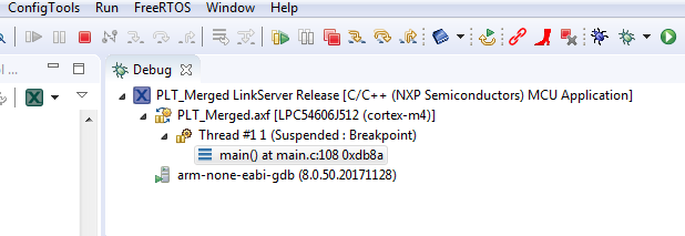

Hi I have similar problem
I have been running all OK this morning and then this afternoon I get this situation
Note the Suspend button is greyed, but also it says thread (suspended:Breakpoint) when in fact the program is running!
I have tried the "Clean Up Debug" button but still no joy.
I am using LPC-Link2 to control the target board.
MCUXpresso version 10.2.1
It is likely that I have altered something in the "Edit Launch configuration properties" page, but I cannot see what it may be!
Any suggestions?

BlackNight
Hi Steve,
I hope this helps,
Erich
4,887 Views
steverudd
Thanks Erich - that has worked !

lpcxpresso_supp
So please can clarify exactly what your problem is and we then might be able to advise better. For instance ...
  • What version of Ubuntu are you using?
  • What debug probe are you using and to what target board and MCU?
  • What exact behaviour do you see and when?
Note that if you are using LinkServer, then you can manually kill the debug related processes if necessary without restarting the IDE. For details, please see the supplied MCUXpresso IDE v10.0.2 User Guide, section 14.12.7 "Troubleshooting LPC-Link2" (much of this is applicable to other CMSIS-DAP probes too). But the main thing here is that  you can use the task manager or equivalent to kill any tasks called:
  • redlinkserv
  • arm-none-eabi_gdb*
  • crt_emu_*
MCUXpresso IDE Support

I use MCUXpresso IDE v10.1.1 [Build 606] [2018-01-02]  on Windows 10.
I'm running a simple "blinky" example on an LPCXpresso LPC1769 (rev. B) eval board and I observe the same behaviour: I was able to start a debugging session once and after I pressed "Terminate", all attempts to start a new debugging session immediately failed with the above quoted error message. I can not press the "the button with the big red square" (as suggested) because it's greyed out.
What seemed to have helped is to delete the launch configuration. Right-click on the project in Project Explorer and select your current launch configuration under Launch Configurations > Delete.
Additionally, I deselected "remember my selection" in the "available attached probes" window (that window opens when a launch configuration is created when a new debug sessions starts and there is no launch configuration in the root directory of your project).
