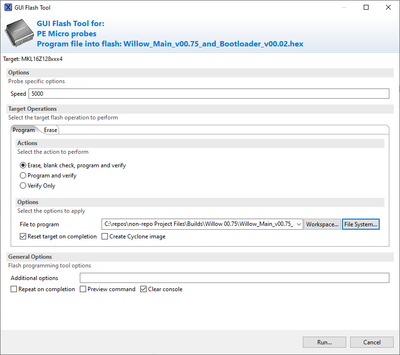

I am attempting to move away from CodeWarrior IDE and instead use MCUXpresso. There is a feature that I am looking for in MCUXpresso but have not been able to find so far. Is there a way to flash a HEX file through MCUXpresso using a P&E Micro programmer while powering the target with the same device?
I have tried using the GUI flash tool which does allow me to flash a hex file but I am not seeing a way to power the device like you could in CodeWarrior.
I see that powering a device is an option in the debug configuration, but I would like to avoid using a debug session for certain use cases.
Also a side question, is there a way to use the GUI flash tool without having a project open?
Any information or recommendations would be greatly appreciated.

I am trying to use the P&E Mirco Multilink Universal FX to program a MKL16Z128VFM4.
Please let me know if there is any other information that you need.

Just to confirm, is there no way to use MCUXpresso to power a MKL16 target using the PE Micro Multilink Universal FX like there is in CodeWarrior?

With MCUXpresso IDE GUI Flash Tool, hex files can be programmed with PEmicro probes but not binary files. Please have a try.
