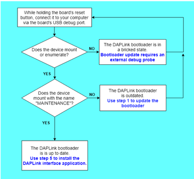

danielchen
Hi @mrice :
Please follow below flow chart to update your boards
Please check below link for details
 https://os.mbed.com/blog/entry/DAPLink-bootloader-update/
If the bootloader is broken, you can use J-link to update the bootloader
https://www.segger.com/products/debug-probes/j-link/
If you don't have the J-Link debug probes, I would suggest you recover the bootloader with anther boards.
check below link for more details
https://mcuoneclipse.com/2016/06/26/how-to-recover-the-opensda-v2-x-bootloader/

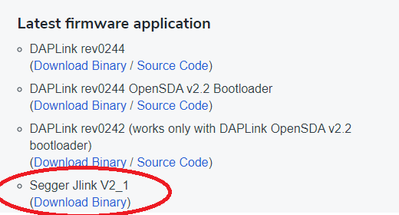

mrice
I attempted to do this but it seems to have made the situation worse.  I downloaded the OpenSDA firmware (.bin) and then plugged in the FRDM-K66 while holding the reset button to put it in MSD mode.  A file explorer window appeared as expected.  I dragged the .bin onto it but then got an error message from windows.  Now the board does not respond at all when I plug in the micro usb, with the reset button pressed or not.  No leds, no notification from windows, and from MCUXpresso the probe search does not find the board at all ("JLink621000000 not found.")
