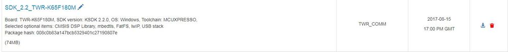

lpcxpresso_supp
Also, make sure that you actually select MCUXpresso IDE as your toolchain in the settings mcuxpresso.nxp.com when you generate your SDK.

juanriveros
This is the Build in the Archive
