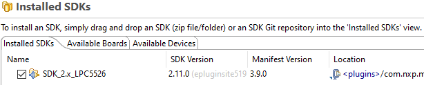

My previous version/installation is MCUXpresso IDE 11.5.1. There, "Installed SDKs" window looks like this:
However, it seems that the SDK was not properly imported into MCUXpresso IDE 11.6.1.

The SDK does not appear in "Installed SDKs" window. Actually, this window is empty as I only need this SDK and have not installed any other SDKs.

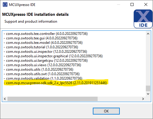

The SDK appears under "MCUXpresso Installation Details":

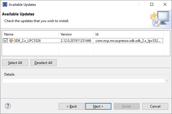

The SDK appears under "Check for updates":
I'm hesitant to update the SDK as this caused the IDE to crash in earlier version ( as I reported  here).
