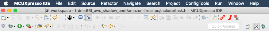

robertoquilez
FreeRTOS plug-ins have disappeared from my MCXpressoIDE (10.3) on mac.
There is no longer "FreeRTOS" menu on the main bar (File/Edit/Navigate/Search/Project/ConfigTools/Run/Window/Help)
When I go to Window/ShowView/Other  there is no any FreeRTOS option.
Is there a way to install freertos TAD back?
In general, I have the feeling that this last version of the IDE is less stable than the previous ones

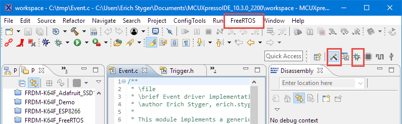

BlackNight
Hi Roberto,
whch perspective are you using? The FreeRTOS menu only appears by default in the develop or debug perspective, but not in the normal C/C++ one. So make sure you are in the correct perspective:
I hope this helps,
Erich

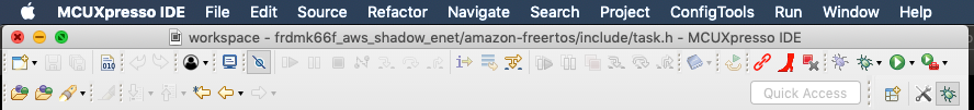

5,084件の閲覧回数
robertoquilez
Hi Erich,
Thank you very much for your prompt response (and you inspiring work on MCU on Eclipse | Everything on Eclipse, Microcontrollers and Software ).
I am using the "default develop" perspective. I have switched to "debug" and then reset both (dev and debug) perspectives but FreeRTOS is still missing.

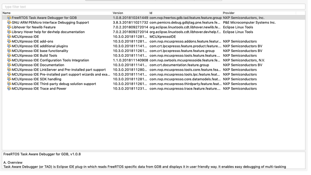

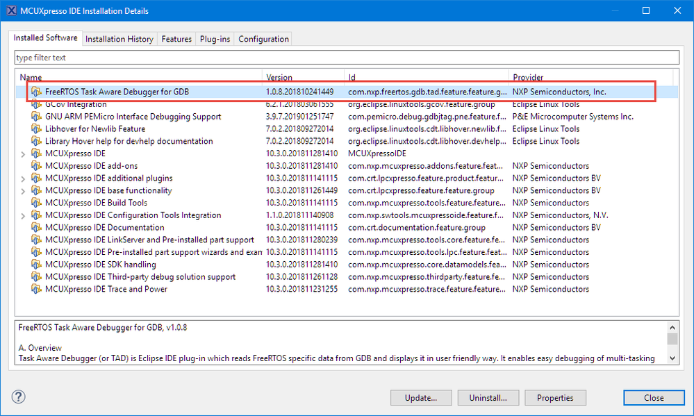

BlackNight
Hi Roberto,
thank you :-).
Not sure why the menu does not show up. A few things to check:
Menu Help > Install New software, then click on 'What is already installed', you should have it present here:
is this the case? If not, I have to check other things...

5,084件の閲覧回数
robertoquilez
Yes it is there.

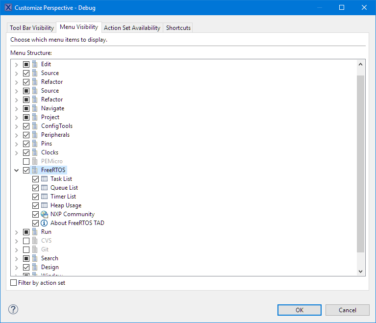

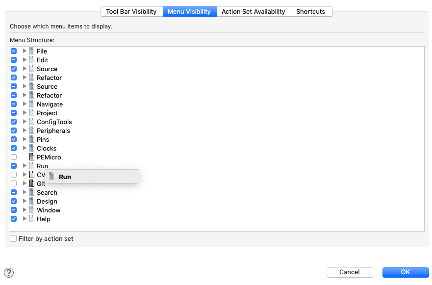

BlackNight
Next check:
menu Window > Perspectives > Customize Perspective:
Erich

robertoquilez
Still not there.

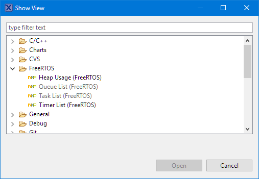

BlackNight
I'm not sure, but maybe there is something obvious I'm missing and maybe Mac specific.
Can you open the views with Window > Show Views?

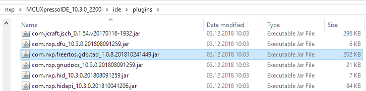

BlackNight
As another data point: that thing had been reported earlier in https://community.nxp.com/thread/481036 . Could you share your workspace metadata\.log file?
5,084件の閲覧回数
BlackNight
And could you check if you have that file present?

robertoquilez
There is no folder FreeRTOS in "Window > Show Views".
Yes, the jar file is there.
You can find enclosed the log file.

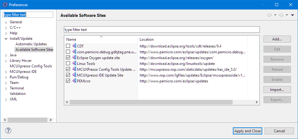

BlackNight
Thanks for the log file. It does not show anything interesting for the FreeRTOS plugin.
But it shows:
!ENTRY org.eclipse.equinox.p2.metadata.repository 4 1002 2019-02-01 16:06:49.977
!MESSAGE Unable to read repository at http://freescale.com/lgfiles/updates/Eclipse/.
!STACK 0
java.io.IOException: http://freescale.com/lgfiles/updates/Eclipse/ is not a valid repository location.
Have you configured this as a repository? Better you remove/disable it:
But I don't think  this is really the cause of your problem.
The other thing I see is that you are starting Eclipse with the -keyring option (which honestly I have never seen/noticed, maybe Mac specific)?
Command-line arguments:  -os macosx -ws cocoa -arch x86_64 -keyring /Users/roberto/.eclipse_keyring
What I suggest is to launch Eclipse with the -clean argument: this will re-search for all plugins, and maybe fixes your problem?
As a last resort: you might have to install the IDE again (this is really the last resort). But it would be good if you could keep a copy/backup of your installation, in case anyone from the IDE team has some more ideas what to check or ways to find out what is not working here.
